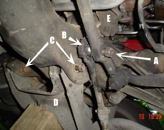

Okay to be able to remove the mounts I'm now on mmy way to remove the whole controlarm (D). Don't know the english terms of these parts so I just lettered them so I can explain.
I'm taking the A-nut off in order to remove B that is in the way of the front C-nut. I need to get the C-nuts off so I can remove D which is in the way of the nuts that hold the the mount (E) in place...... Hope this is clear enough..... Feel like I'm playing Tetris here, haha!!
It's B that is stuck... or is it? Can't get it apart from the "steeringshaft". Does anyone know how it comes off??
Please ask if something is unclear.
