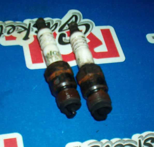

here are two of my pitch black spark plugs,
as you can see they were running rich. There was no lean condtion here. all 6 i pulled looked identical.
Also, once you have the fueling issues fixed, you can then play with the timing and see if that helps. If your in doubt about the timing mark (I always am with alot of these balancers), you can just asvance it by ear and with a vacuum gauge (with the est connected this time). Shoot for best vacuum and idle.
