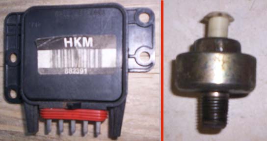

The knock sensor is located between your starter and the fuel pump in the side of the block. The knock module is located on the firewall above the wiring stands on the driver's side (see photo). The KNOCK tells the Module if it "SENSES" detonation and the module tells the ECM to adjust the ignition timing to compensate.
You should have a Baro Sensor on the lip of the firewall, passenger side, above your tranny dipstick. It looks IDENTICAL to the MAP but it is in fact different. The MAP is located on the Driver's firewall (also above the wiring strands). The Map has a vacuum hose to the manifold (rear of carb). The BARO has no hose.

I do believe the picture you posted on the left is the ESC module, not the map or BARO sensor as you explained.

Sorry for any confusion. I do not think I referred to the photo as the MAP or Baro.
An ASE/GM Technician gave me the explanation of the working order of the knock module and sensor that is shown in the photo. Hopefully, he did not give me bad info.
The knock/ESC module is on the left in the photo.
The knock sensor is on the right in the photo.

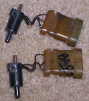

I believe the brand of TPS that AutoZone sold me was a "Wells". I think I paid about $20 and it was all plastic also.
JP86SS mentioned a possible problem with the ground wire. I have followed EVERY wire in my engine compartment and taken the covers and tape off of EVERY SINGLE wire and thoroughly inspected every inch. I found nothing wrong or damaged in anyway. I don't know what similarities/differences there are with the TPS sensor on the TPI intake system. I would assume they are more different than similar.
PHOTO: I have quite a collection of Throttle Position Sensors as well. Only one of my "Several" spares failed a resistance check.... It's marked..... Regardless I bought a new one and installed it.
