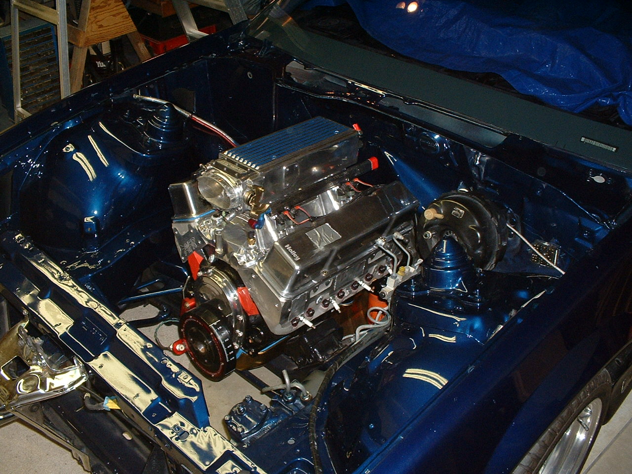

update on an old post. Got the motor bolted in about a month ago, then went and put in a 94 T-56 With a Mcleod street twin and Mcleod Slick Stick, spohn torque arm, Custom 3.5" aluminum shaft, and a moser 9" with 35 spline axles 4.11's and a detroit locker. I thought I'd snap a Photo of the motor finally in between the fenders. More to come.

very nice, very clean! Puts mine to shame (not that its much to see anyway). What is that bracket you have in front of the balancer?

Bracket is for the crank trigger.
