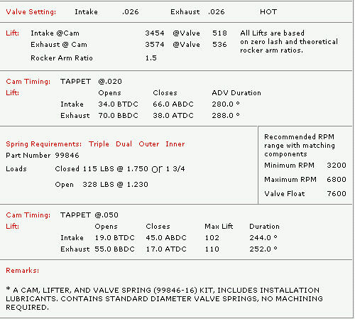

You'd need all the cam specs to come up with anything meaningful.

I have all the cam specs, I just need to know what to look for on my spec card. Doesn't make sense that I am getting 2 very different reply from DD. And the compression should be 10.8 to 1 with 64cc heads. And would changing to a flat tappet solid cam be an improvement? Here is the info on the current cam:

Sorry, here are the cam specs

Well that 300 degree monster is probably too large for those heads.
