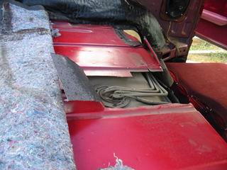

not my car but this may help

And your probably glad it isn't too! That has got to be the hack job everyone claims is crap and I have to agree. Looks like someone just started cutting away with no forthought at all!
I've got an acess hole too but it's covered nicely and doesn't go past the bend in the floor pan weakening the structual integrity.
If you go to the TBI forum and read the post "for those who did fuel pump access door" you'll see some pic's of some access door's done right!
