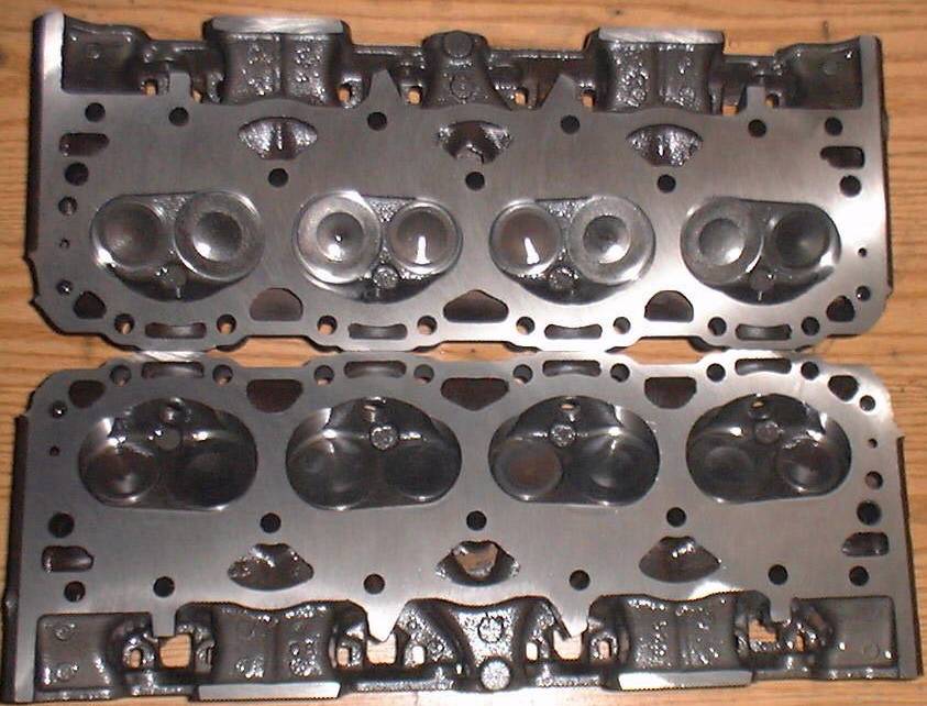

Here you go

Engine: L69 305 H.O.
Thanks for the pix, I actually saw that on another post, but how would I recognize them attached to the car. Is there a casting number or something to look for?
14022601
You can find them on 4bbl versions of truck engines. I see alot of trucks with 416s on them down here though. Your best bet is looking on Vans from about 1982-1986. Chances are they will still be mounted on the van as well.
