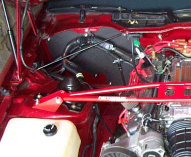

Here's a pic of Traxion's old Iroc. He's deleted the AC, AND THE ENTIRE box and blower all together. He simply put a black panel over the hole in the firewall.
Attached Thumbnails A/C delete Q's-acdeletetim.jpg
