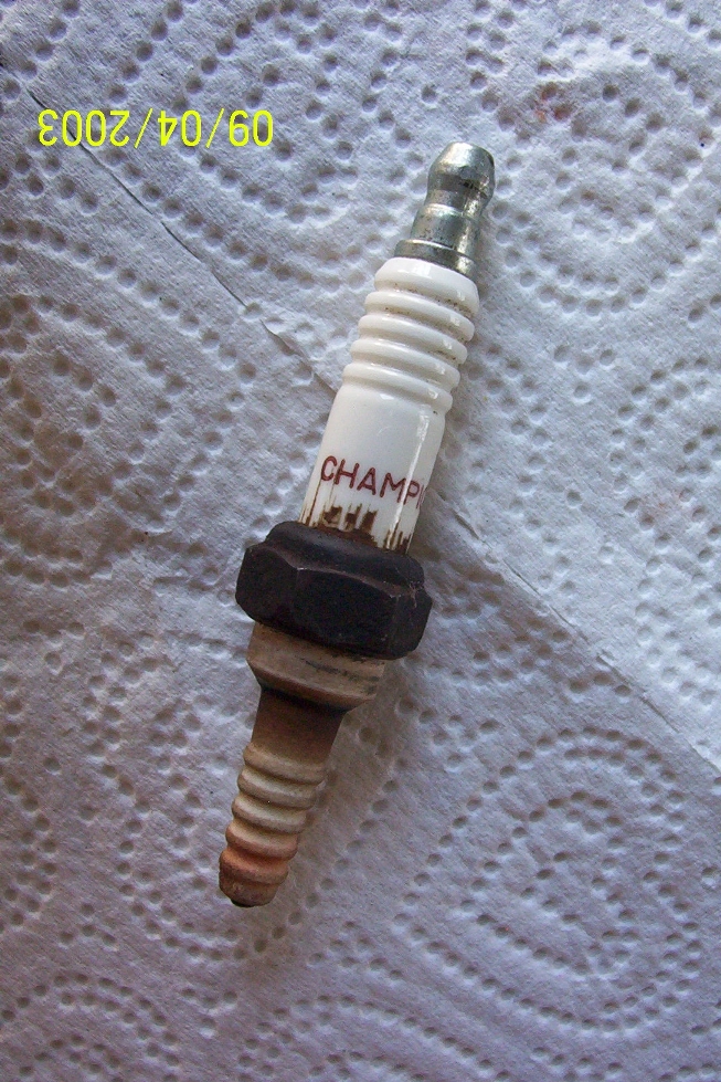

Do you mean like this?
Find a set of Champion plugs and that won't happen again. Use antiseize compound on the plug threads to help prevent that.
After allowing the penetrating oil to soak in and work, try an extractor. You may have the best luck with a straight-flute extractor, since a reverse sprial type (like the typical E-Z Out) will expand the thin plug shell and make it even harder to turn. Make sure the engine is rotated so that the piston in that cylinder is not near the top of stroke before you go sticking an extractor in there.

Vader; the one that broke off is a champion. I did buy the square extractor as well. Right now I'm letting it soak. The car is new to me, so I didn't put the plugs in, or I would have used anti-sieze.
Attached Thumbnails Broken Spark Plug Threaded Part Still There-champion.jpg

Thanks for the tips everyone--I got it. Persistance, a whole bunch of penatrating spray, and some skinned knuckles; didn't have to pull the head though.
Attached Thumbnails Broken Spark Plug Threaded Part Still There-spark-plug-thread-end.jpg
