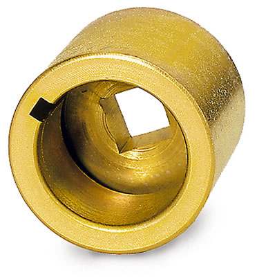

The whole idea behind "do NOT use the bolt" was to have you avoid using a bolt to turn the engine.
Using either what Vader mentinoed (via the flywheel), or purchase one of these 2 tools:
The first is the crow-foot tool that attaches to the damper, the second attaches to the crankshaft snout itself (damper has to get removed for this).
