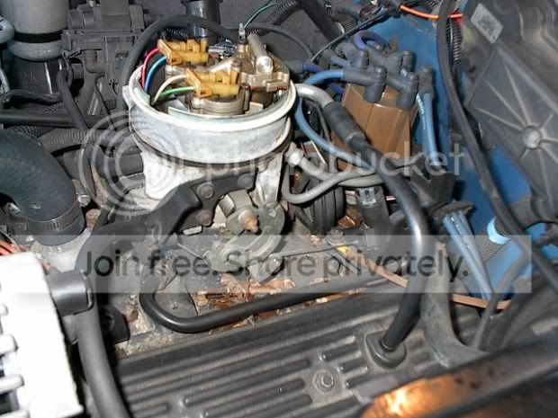

Old Jul 29, 2006 | 12:19 AM
Randy82WS7's Avatar
Posts: 4,812
From: 62656
Car: 1991 S10 pickup 2700lbs
Engine: 4.3L Z TBI
Axle/Gears: 3.08 7.625"
in 87 and up they are center bolt from factory
yours are perimeter bolt style, thats 86 and older
center bolt style 87 and up:
86 and older perimeter bolt style:
