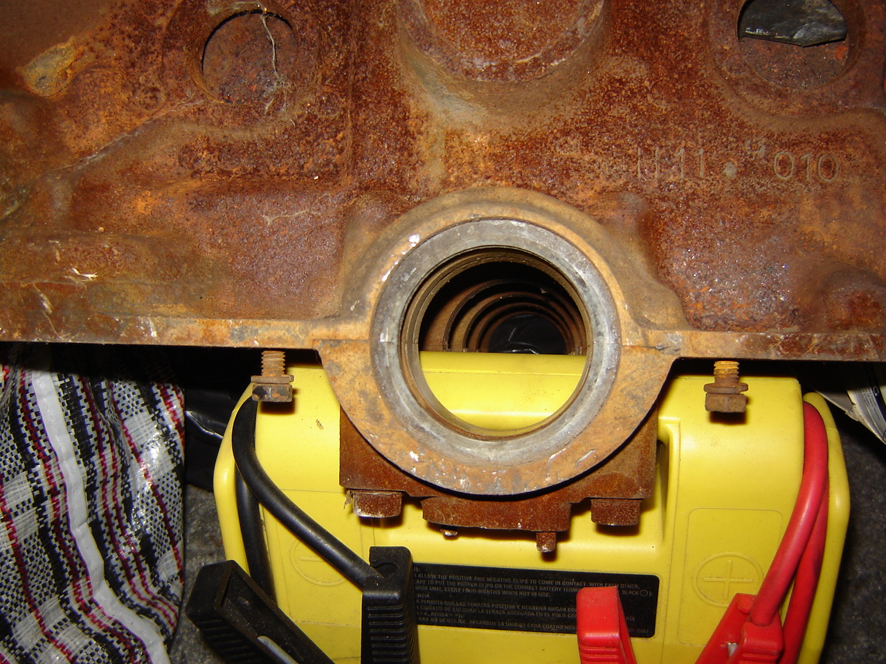

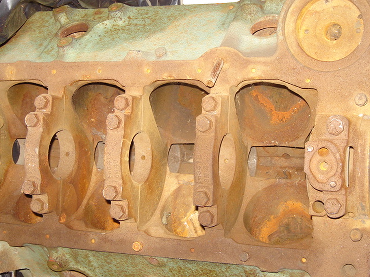

well the cast number is 3970010....350...69-80... 4 bolt here are some pics and the dip stick is on the drivers side and the 2 bolt in my yard the rear mane is the same as on the 4 bolt it looks like

That blocks gonna need a whole lotta work to clean it up.

everybody and there dog has an 010 block. It's the single most common iron casting on earth i'd say.
That block however, is FUBAR. I don't even think it'd be worth rebuilding. Your machinist is gonna bust a gut when he sees that.
Might want to use the 2 bolt you've got laying around, if it's any better than that.

The machinst would bust a gut because that block is a friggen mess. It should be put back into service as a boat anchor.
Unless you are planning some serious power out of that 383, I dont see a reason to bother going to a 4-bolt.
