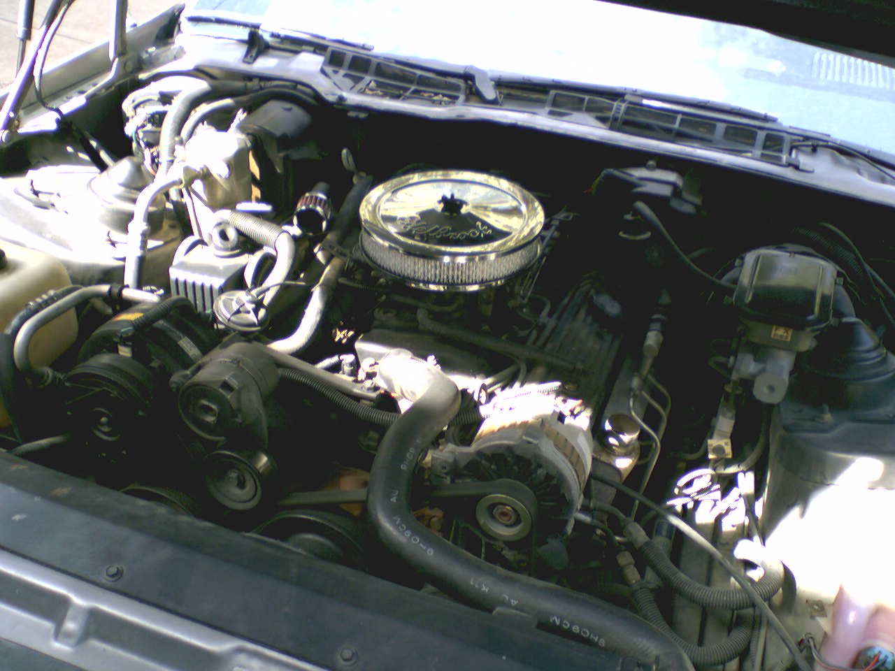

I'm the wife
Hi everyone. Here's a pic of the engine if it might help a bit. I want to mention that the first time the car started hesitating, it wouldn't move when I tried flooring and and the engine wouldn't react at ALL. I had to pump the pedal to get it to move bit by bit. Needless to say the people behind me probably thought I was an idiot moving at 5mph then stopping over and over again.
