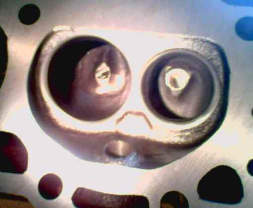

For mild and moderate performance builds, they work very well. Here is a pic of a ported and deshrouded chamber.
vale size is 1.94x1.60" chamber size is 61cc.
