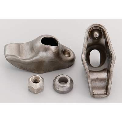

on my 86 camaro z28, there is ticking noise coming from the rocker arms, i had them adjusted and they still do it, i was wondering if they can be wore out, i was thinking of replace them, with new ones, and i dont know what kind to get, my engine is little work done not much, can someone give me advice on them , and how to replace them and adjust them, and the pushrods while im in there, thanks for all your help

whats the differents with this one, this is the one i have on my car
ahd this part below

Is it a loud tapping noise like when you back it off the rocker arm nut, or kind of like a sewing machine? Also, do you have flat tappet or roller lifters?

flat tappet
it sounds like a tapping noise, at idle i cant hear it , when i press the gas it gets louder, the fast i go m the louder it gets
whats the different with tapping and sewing machine sounds

If you back off the rockers they tap loud. Is it the same noise after they're adjusted? Rocker arms shouldn't make noise unless they're fubared. Are you sure it's not an exhaust leak?

what do u mean backing off the rockers,
i did think it was an exhaust leak, and my exhaust was leaking, and had the pipes replace, i might be leaking from the headers,
its coming the passenger side it sounds likes the rocker arms. it might be leaking from the headers, the bolts are tight, i will try to replace the gasket and see what happens, i had mechanic adjust the rockers, the rocker are tighten to specs

umm, that's how you adjust them.....by backing of the nut with the engine running, tightening it to zero lash (tapping noise goes away), and then going an extra 1/2 to 1 full turn. My question in a nutshell is when you back them off with it running, does it make the same noise that you're hearing or a different one?

Then I would ask whomever adjusted them if it's a valvetrain noise. WAG is it's a header leak. Good luck.
