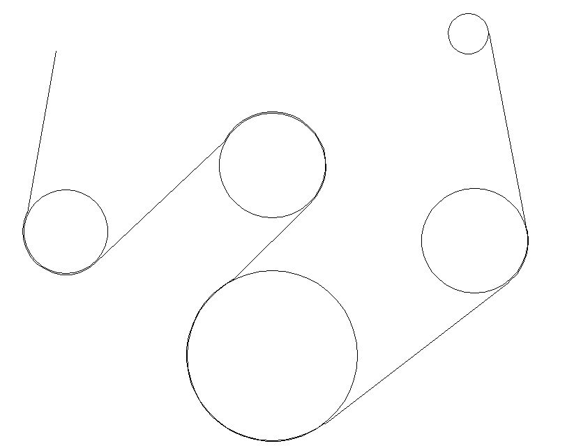

this is what i found its all set like this in the grooves but still wont come up enough to come onto any pulleys and ive tried just about all of them

Try this, may be a shorter path (I think it is)

put the belt on all the pullies except the alternator,push tensioner all the way over ,then put it on the alt.later jimmy

i got it, was trying to get it on using the wrong diagram, but it was the only one i could find here
