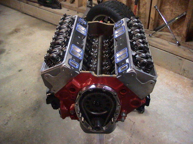

this is a new motor, Im at the point to where I want to set my rocker lash.
I was at TDC #1 and want to turn the crank to TDC #6 so I could set the other rockers but once I get to a certain point the crank becomes WAY to hard to turn and I dont want to use the bolt to turn it. It turned freely but see now I have the valves that I have already set opening and closing making it harder to turn.
heres where Im at.

Nice pic, that makes me want to get everything for my 383 even quicker! And that block color would look pretty good in my car I think...
OK, enough drooling. When I ask this, keep in mind that I'm not trying to be insulting, but I've learned in life that (generally speaking) it really pays to ask the dumb/stupid/obvious questions - so here goes:
Have you checked (and dbl-checked (and triple-checked)) piston-to-valve clearance??
Like I said, not trying to be a smart-@ss, just trying to cover all the bases.
If so, and if you've got plenty of room there, it might be helpful to try turning the crank using a beam-style torque wrench & seeing how much torque it takes to turn it. If memory serves, an average engine shouldn't take more than about 20, maybe 25 ft-lbs to turn over... (Anyone else want to chime in on that number??)
Got to get to other things now, but I'll check this thread tomorrow. Good luck!
heres where Im at.
dude nice engine but im really worried about that cork gasket setup you got to seal the intake manifold...you should use RTV silicone, a 1/4" thick beed on the block...run it from the left gasket to the right and have the silicone overlap onto the gasket. ive seen that cork **** leak so much its embarrassing.
some say they leak others say they dont..they came with this sticky crap on the bottom side and they dont seem to move...what Im going to do is run the RTV up the sides onto the intake gaskets...and run a very thin coat of (brush-on)High Tack gasket sealant on the top of the cork...and also Im going to put some RTV on the backside of the cork ....
I like the way the cork fills in the big gap of the HSR..
