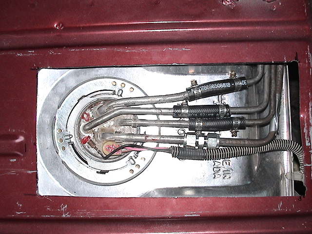

I also had to do the same for my '88 when I found a leak at the filler neck, and much to the admonishment of some TGO members, I installed an access door above the tank, and modified the fuel lines to allow removal of the fuel pump from above.
