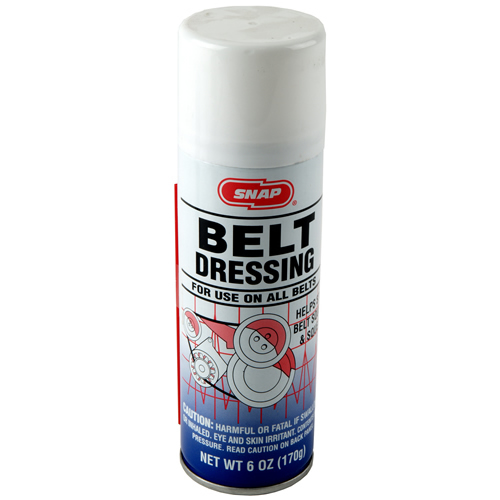

try some "belt dressing".. but it is supposed to stop squeeking when you tighten it.. try tightening it till the noise stops.. deflection should be no more than about 3/8" with a nice pressure.. if it doesnt help, get the belt dressing stuff..

what is in the belt dressing that stops squeeks?

i hate belt dressing, it makes everything it gets on sticky & it holds dirt, i have also had it cause as much belt squeak as the squeal it stops.

I used some belt dressing and it seems to have fixed the problem.
