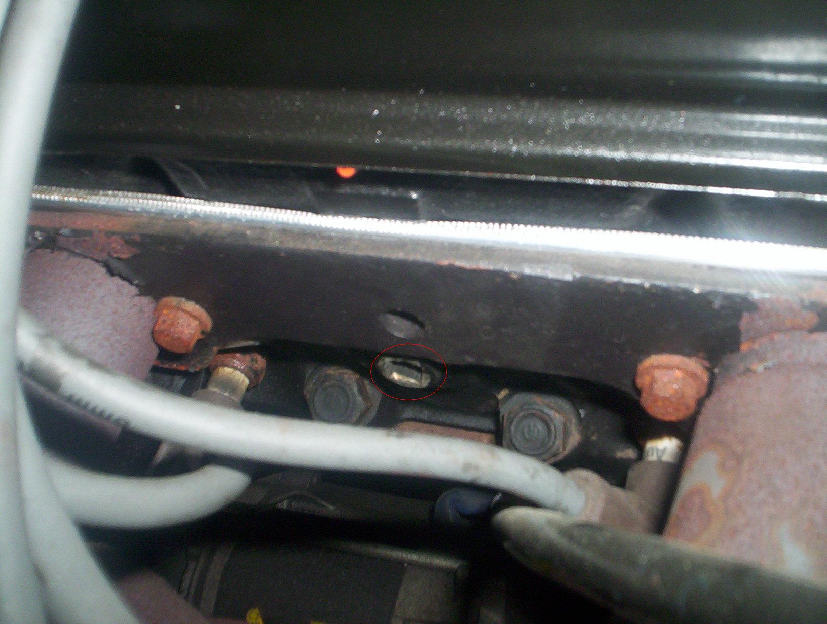

There is a pipe plug in my passenger side head that was installed by my engine shop back when I had the motor built. It is taking up the fan switch hole and I'd like to get rid of it now because I have a new Hypertech cool fan switch to go in there, and I would like to remove the constant drain on my battery by having my fan relay jumpered.
Problems I'm having is it is a sqaure head, and it is not 3/8" drive (too big), 1/4" is too small of course. Someone local recommended a piece of bar stock but I'm not going to buy every random size.
Has someone removed these nicely before? What tool was used?
I'd like to know because a family member obliterated one with a screwdriver in his old car and it was stuck permanently and I don't want that to be the case here.
Plug in question is circled in red in the first pic. Thanks!
Attached Thumbnails Square head pipe plug removal? Special tool?-100_4581.jpg   Square head pipe plug removal? Special tool?-100_4583.jpg

Thats supposed to be a 3/8" ratchet job. Maybe its just dirty/damaged and thats why it doesnt fit.

Another way of dealing with it is to drill a hole in it, and use one of those GREAT BIG bolt extractors on it.
Heat helps A WHOLE LOT. In fact, no matter what you try to turn it with, I'd suggest getting it just about red hot first; and maybe rapping on it with a hammer to break the rust.

I have a tool at work that is slightly angled to be able to pound into a plug like that, for differentials covered in rust. it's got a chamfer on each side, to allow material to slide through. It never fails. But yes, that's a 3/8" square plug. Try getting a little screwdriver in there to remove all of the excess crud.
