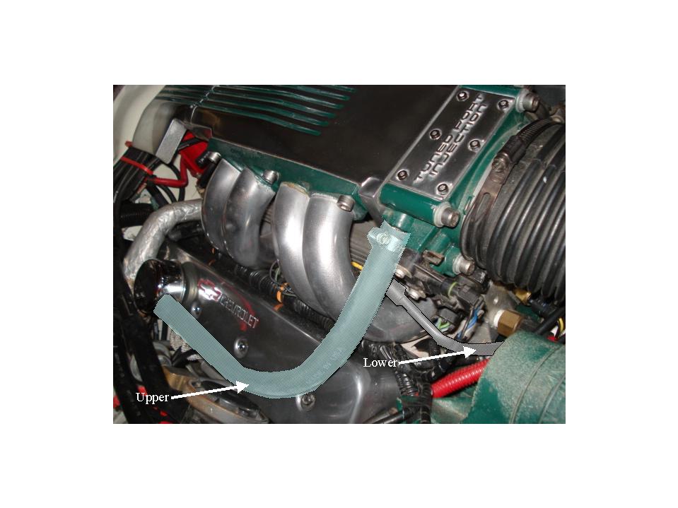

Ther should be one vacuum line going to A/C control head, and one coming from it to the heater coolant flow control valve. There is no emissions tubing going to the heater valve in the emission sense, only vacuum.
TB Upper hose goes to right rear of valve cover breather.
Lower hard hose goes to canister.
There could be a 3-way check valve connected to the plenum, A/C control head, and vacuum reservoir (black ball located under canister and behind left, or right headlight.

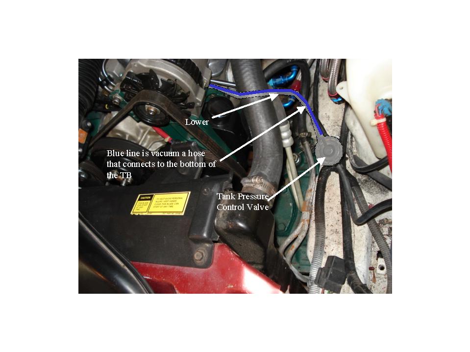

Re: Vacuum lines misplaced/unhooked?
I don't use the A/C, Heater Valve, or the EGR so I can only show the the TB stuff. I high-lighted the hoses in the pictures for clarity.
Vacuum lines misplaced/unhooked?-hoses1.jpg
Vacuum lines misplaced/unhooked?-hoses2.jpg

1. Mine seems to match the 90-92 diagram except for the tank pressure control valve is on the line that crosses underneath the TB to the lower port on the right side of the TB. This is the line that should go directly from the top port of the canister to the right side lower TB port.
