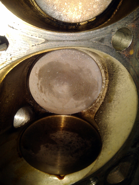

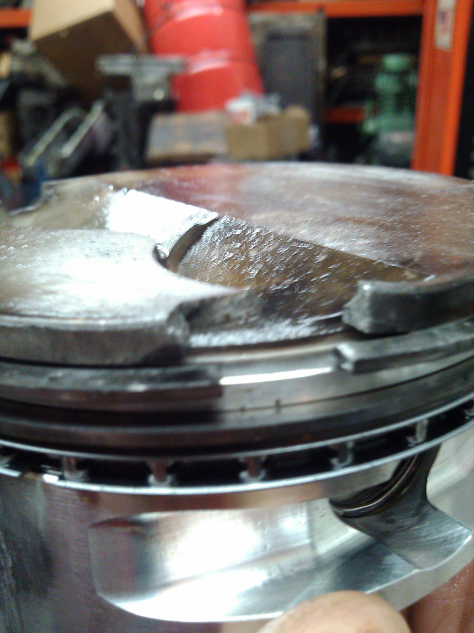

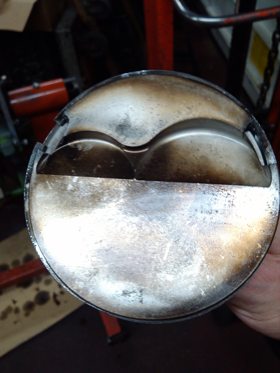

My engine knocked itself to death TWICE..
13:1 compression.. big cam, yadda, yadda, yadda
The culprit was insufficient octane of the fuel.
DO YOUR HOMEWORK I wish did, because E85 is not truly 105 octane.
The RON is high (105) but the Mon is very low... (90)
R+M /2 is really 94-96 octane for pump grade
98-99 for race grade VP or Sunoco.
I can show you pictures of the so called "cooling affect" on my pistons.
What a bunch of hype, the truth is out there... so plan accordingly, If I only spare 1 person the frustration and expense I have been thru it was worth posting this:

If I had to do it over the most I would have ever planned for is 11:1 static compression based on the "real word" octane values of E85, & not the hype in the car magazines.. if you read these articles most of them never exceed this 11:1 limit... IRONIC ?!
I am going to switch to 112 race gas, which was the original plan for this build.

In total 4 piston damaged.
#8 the worst
#6 deformed at the valve relief (look at the picture) see it's not round @ 10 o'clock position.
#5 & #7 top land erosion
looking at the cylinder heads you see those shiny speckles on the face of the valves.... that is piston material.
Text book detonation.
bye bye E85...
