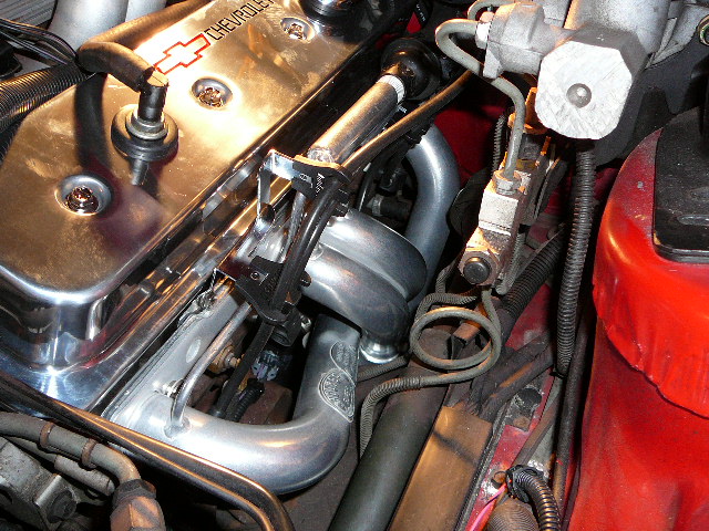

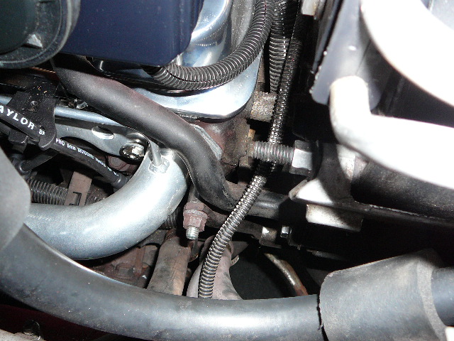

I've got the Proform Aluminum covers and 1.6 rr's. A/C line clearance is no problem. On the left side I use the std. location for the pcv and oil fill cap. On the r/s I blocked off the return breather line to the throttle plate and went w/ an old style open breather. These photos are after the header install but before I decided to de smog. The breather, pcv and oil cap are all visible and did not change, Joe
