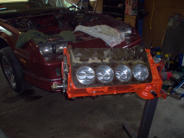

Some pics of my build

Hey guys, first and foremost thanks for all the help everyone has given me with questions about my build, here are some pics. On to the specs...
1987 L98 Block
Bored .030 Over
.030 Flat Top Speed Pro Hyperutectic Pistons
Stock Crank (only required polish)
Vortec Heads, 3 Angle Valve Job, Resurfaced, Screw in studs
New Valve Springs (not sure what brand machine shop sourced them)
LT4 Retainers
Comp Cams XR276HR Cam
Reused Stock Roller Lifters (good condition)
Professional Products Single Plane Intake
Holley 3310, 750 cfm Double Pumper
Double Roller Timing Chain
Hasting Chrome Moly Rings
Clevlite Bearings
Fel-Pro Gaskets
Th350 with B&M shift kit, upgraded clutches etc, 2800 stall converter
I think that's about it Let me know what you guys think!
