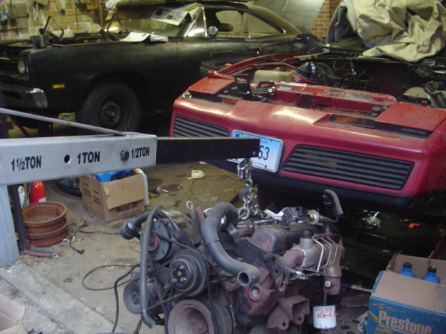

I got-r-out once I made the firechicken tool (bent 9/16" wrench) to get them darn BH bolts.
This car has metric AND SAE hardware??
