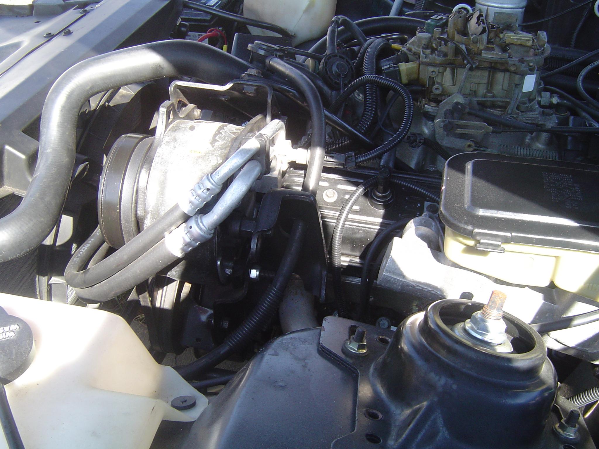

Old Oct 11, 2007 | 04:06 PM
naf's Avatar
naf
Joined: May 2004
Posts: 5,338
Likes: 73
From: Lexington, SC
Car: 1987 SC/1985 TA
Engine: 350/vortec/fitech
Axle/Gears: 3.27 9-bolt
Re: Installed headers car vibrates hard when using A/C
There's another bracket that supports the A/C compressor that is difficult to re-install with the addition of headers. It is U-shaped and mounts to the forward two exhaust manifold bolts in stock form. With headers a spacer is required to re-attach it and it may need to be trimmed to clear the headers.
Loss of this bracket could easily cause vibration problems when the A/C is on at low rpm. Once it spins up the vibration problem won't be as apparent.
If you think this may be your issue, I can post a photo of the modified bracket on mine.

Old Oct 15, 2007 | 11:37 AM
naf's Avatar
naf
Joined: May 2004
Posts: 5,338
Likes: 73
From: Lexington, SC
Attached are two photos. The first shows the bracket on the rear of the compressor and you can see where it had to be trimmed around the headers (it used to mount to two exhaust manifold bolts). The second shows the nut on the stud that is used as a spacer for the bracket. In stock form it mounts to the outside of the manifold which is an inch plus away from the head, not so with the headers.
Attached Thumbnails Installed headers car vibrates hard when using A/C-acbracket.jpg   Installed headers car vibrates hard when using A/C-bracket-mount.jpg
