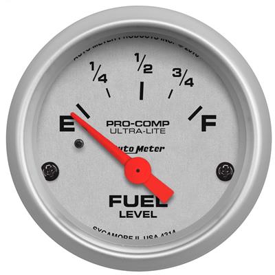

Any info on gas Guage greatly appreciated
Doing a gauge cluster in the camaro.......Tach Speedo oil and water aint a big deal.......Gas guage.....kinda has me stumped.....
How big of an ordeal would it be to drop the tank and install an aftermarket sending unit for the new guage? or maybe somebody knows about a guage with the right ohms to fit the stock sending unit? Any replies are appreciated

No need to change the sending unit, our cars use a 0-90 ohm scale to read the fuel level. I used this gauge for my dash and it reads perfect. there are many options in autometers line.
http://store.summitracing.com/partde...5&autoview=sku
