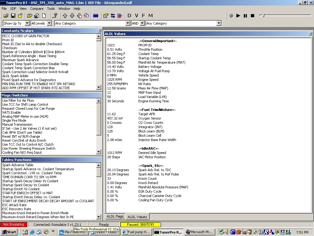

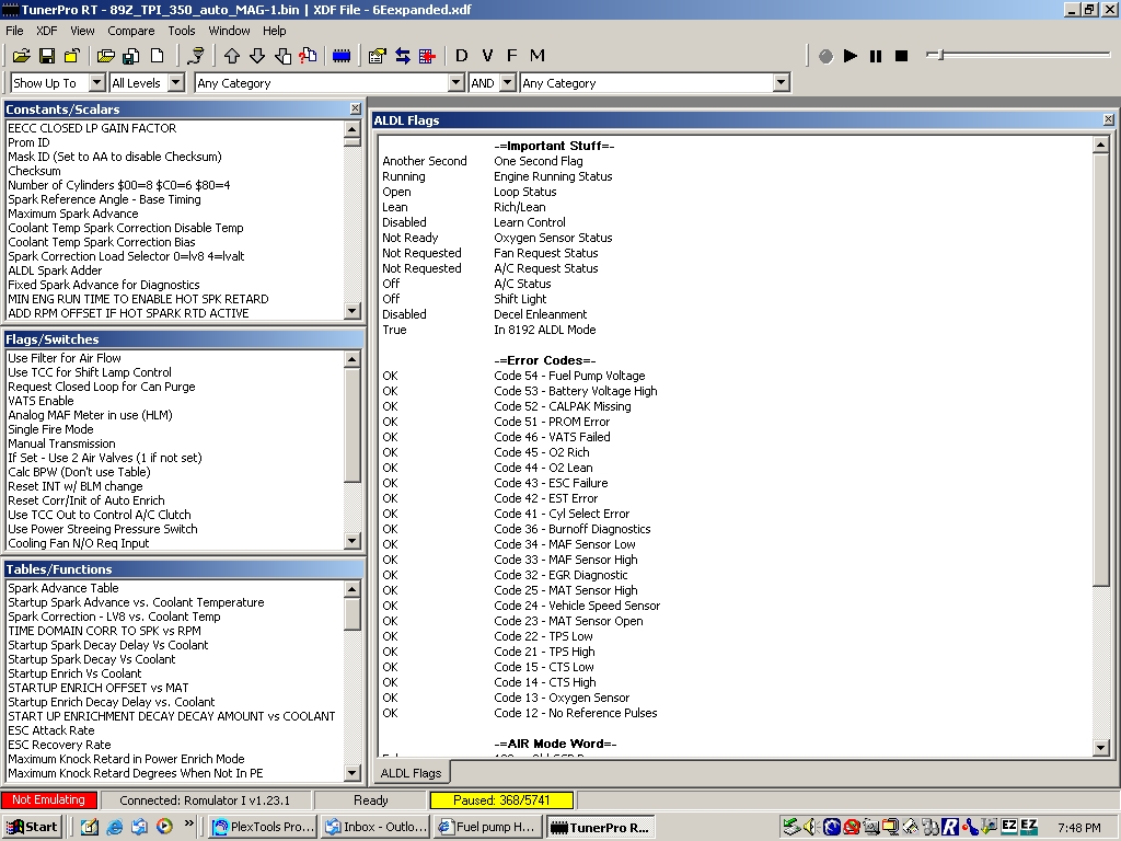

THe ALDU1/Cable1 allows a Computer to Scan the ECM for Codes & clear them. You can monitor and log any/all signals of the data stream.
You can edit the file, say for larger injectors and save it then use it to reprogram you ECM with a chip burner, or have someone burn it for you.
I use a chip emulator so I just make the change and upload it on the fly.
I've reprogrammed my injector size, base timing, and fan control.
I plan on keeping my Z for the rest of my life so these tools are necessary for diagnostics and tuning.
