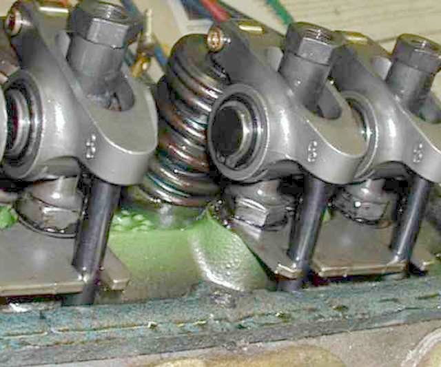

if im not mistaken you cant run guid plates with screw in studs
That's how you attach guide plates to heads.
Why self-aligning?
If that's what you need, use 1418 instead.
Here's how guide plates and screw-in studs look.

i dont think vortecs use guideplates or are setup to run them without machine work, so go with the comp 1418's
i used them for my L98 and they worked great! great price. best place to get them is on ebay from a seller named discountperformanceparts.

ok my machine shop guy said i could run the guideplates, why wouldnt i be able to??
I can cant i?

i think the heads need work to allow guide plates to bolt under the rocker studs and the pushrod hole enlarged. I'm not sure tho but i dont think they ever came stock with guide plates so dont use them since you dont have to. simple self aligning rockers are more than enough

The reason im asking is because i am going to do a full roller rocker after all, its either a non aligning rocker, with guideplates, and hardened pushrods, or Self aligning rockers and stock pushrods, it was gonna come down to price or if i could even use the guideplates.
