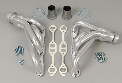

What do you think about this kit.
Brand:
Flowtech
Product Line:FlowTech HeadersPart Type:HeadersPart Number:BIG-31102FLTHeader Material:SteelHeader Finish:Ceramic coatedHeader Style:ShortyPrimary Tube Diameter (in):1 1/2 in.Collector Attachment:3-bolt flangeCollector Diameter (in):2.500 in.Tuned:NoPrimary Tube Gauge:18-gaugeFlange Style:StandardFlange Thickness (in):5/16 in.Bolts/Studs Included:YesGaskets Included:YesReducers Included:YesY-Pipe Included:NoQuantity:Sold as a pair.
Headers, Shorty, Steel, Ceramic Coated, Chevy/Pontiac, Camaro/Firebird, 5.0/5.7L, Pair
Maximum performance with FlowTech headers.
These precision-engineered FlowTech headers are leak-tested to get maximum performance and fuel economy from your engine. They're made from .049 in. cold roll, flash-controlled tubing, and feature FlowTech's mandrel-formed Power Plenum collector. All ports are precisely fitted and finished with durable, leak-proof, O-ringed port seals. The headers are available with either a high-quality, electrostatically applied, satin black painted finish, or with a silver luster ceramic coating for rust and corrosion resistance. In addition, they come with all mounting hardware, including bolts, nuts, and premium gaskets.

Those headers are the coated version of the headers I used to run. I had to dimple one of the tubes to give the plug some room and the optional Y pipe is not the greatest. Overall they work beter than the stock stuff but are not the best. I would buy the standard version for a lot less money because you will want better headers later on.
Removing the AIR system makes no real power difference and neither does the A/C. I would rather add power with cams and save weight with fiberglass hoods but everyone is different.
Removing any emission equipment is illegal but that does not stop anyone.

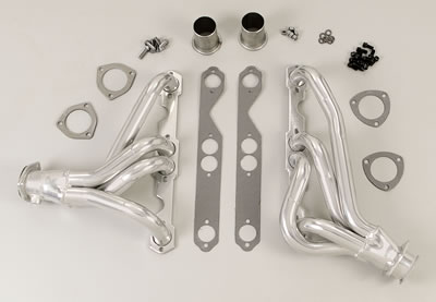

I'm not going to do any major work to my 305 b/c with in the next year i will be putting a 350. I want to buy headers that will also work good with that motor to. The motor that i will be putting in will be pretty powerful making mid 400 to the rear.
So will these headers be good?
Brand:Hedman HeddersProduct Line:Hedman Elite HeddersPart Type:HeadersPart Number:HED-68478Header Material:SteelHeader Finish:Thermal coatedHeader Style:ShortyPrimary Tube Diameter (in):1 5/8 in.Collector Attachment:Ball and socket flangeCollector Diameter (in):3.000 in.Tuned:NoPrimary Tube Gauge:14-gaugeFlange Style:StandardFlange Thickness (in):1/4 in.Bolts/Studs Included:YesGaskets Included:YesReducers Included:YesY-Pipe Included:NoQuantity:Sold as a pair.
Headers, Elite, Shorty, Steel, Thermal Coated, Chevy/Pontiac, Camaro/Firebird, 5.0/5.7L, Pair
Hedman Elite Hedders offer extra heavy-duty construction for hard-use conditions.
Hedman Elite Hedders are made with ultra heavy-duty, 14-gauge steel tubing. They feature a bulletproof 3/8 in. flange and a thermal coating for intense heat conditions. Hedman Elite Hedders are designed to take the pounding and vibration of off-road conditions, as well as extreme hard use, the heat buildup found in motor homes during towing, and performance situations. Hedman Elite Hedders can take the abuse and keep on going when other brands fail.

They are a much better choice for power. Hopefully they have a good fit.

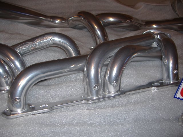

Hey man i was woundering my dad put some really nice headers on the mustang and after like 2 hours they turned white and ugly will these do that to?
thanks
kevin

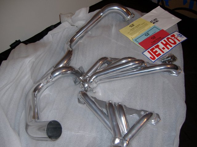

Without any kind of coating on them, they'll be rusty in a month. The black paint that comes on them usually burns off within a few days. Ceramic coating is expensive, but if you want them to stay nice looking for any amount of time, it's the only way to go. You might want to go to Jet Hot Coating's website and get in touch with them. They have the 2055's available with the ceramic coating, and it's far better quality than the coating that Hooker or Edelbrock offers from the factory. They'll also remove the air tubes and weld the holes shut before coating them if you request it. Here's a couple of pics of my 2055's from Jet Hot. I've tried just about every paint known to man on headers in the past, and none of them stay on for long. Getting them coated is the ony way to keep them looking good for a long time.
Attached Thumbnails smog pump removal HELP!-headers.jpg   smog pump removal HELP!-headers2.jpg

If i can ask you how much did that cost? I just want the headers chrome like that i wouldent really care about the y b/c you wouldnt ever see it.
thanks
kevin
