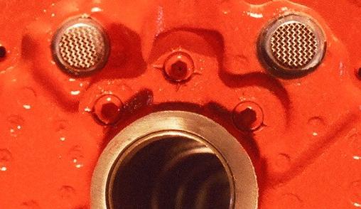

Originally Posted by Apeiron
Did you change the timing set with the cam?
I was thinking the same thing, did you by any chance install a double roller timing set with a roller cam and forget to clearance it?
Old Jul 18, 2008 | 05:38 PM
v10viper04's Avatar
Joined: Nov 2006
Posts: 1,724
From: NY sucks

Re: HELP!!! Cam swap problems...
its a Flat tappet cam with a double roller timing set and all i did was put it on.... think thats it? i'll have the timing cover off in a little bit to see, i'll look for metal shavings lol
That's probably it. The double roller chain is wider than the stock link chain, and now it's rubbing on the bosses around the oil galley plugs. You can clearance the block with a die grinder if you're careful and make sure you catch all the chips.
they normally make contact at the very top 12 o'clock position of the boss around the top oil galley plug there, which is where you normally need to clearance it. Hopefully that's all it is and you'll get away cheap
Yup, just have to go to town on it with the die grinder.

Well i have the engine apart right now, i'm not seeing anything worn out, but i'm getting TINY bits of shavings of metal in the oil.. Its annoying b/c i can't find anything wrong.... everything looks fine to me....
Old Jul 21, 2008 | 08:02 PM
v10viper04's Avatar
Joined: Nov 2006
Posts: 1,724
From: NY sucks
Car: 84' Corvette, 96' Caprice
Engine: LT1, L99
Transmission: T-56, 4L60e
Axle/Gears: 3.07 POSI, 2.93 Open
Here are some pics of the Motor/Cam............

Engine: Built ls1
Axle/Gears: 3:42
well i dont know if this would cause your noise or not, but seeing as you have a roller block and you are using a flat tappet cam, did you install the cam and use a thrust bearing? Im not sure if it goes before or after the retaining plate, but for flat tappet cams there is supposed to be a thrust bearing used.

If the thing is making that much noise, it's got to be noticeable at some point when you turn it over by hand. Keep checking everything at every step when you put it back together.
No there isn't.
or a retaining plate..
I'm kind of grasping at straws here, any pictures of the backside of the timing cover and the timing set you're using?
the area where the retaining plate would go on a roller cam setup around the front cam bearing looks like it's kind of shiney, but I can't really tell from the picture, there isn't anything rubbing there when it's all assembled is there? Just throwing it out there..
Just the back of the cam sprocket, like normal.
I can't really tell but at the top it looks like there's a little metal flake kind of hanging off (straight down from the middle galley plug slighly offset to the right) and on my screen it kind of looks like it's gouged a little.. hard to tell from the quality of the pictures though.. probably just my imagination but I figured I'd throw it out there for him to take a closer look in person.. not really seeing anything else..
could that spot where the top of the cam sprocket is rubbing the block be it? i never greased it up or oiled it... idk it it has any oil on it at all.....
where the back of the cam sproket rubs the block...
Where is it rubbing the block?
