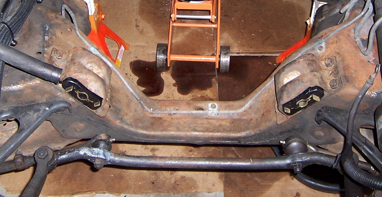

Get a cheap loong 15mm box end wrench to reach up into the frame thru the holes to hold the nuts. You will probably have to bend the end of the wrench slightly to get on the nut thru the access holes. Use an impact wrench on topside or a helper you can trust.
The nuts in the frame have washers. Silicone these onto the nuts Nascar style while you're drilling the rivets in the clamshells and figuring out which way the new mount go into the clamshell. Only one way is right.
When the glue has hardened on the washers, you can put the nut in the boxend wrench and it will stay there as you put it up in the frame. Start the bolt into the nut by hand.
It's just time consuming and frustrating, but not that hard. Good luck. It should look like this when you finish:
