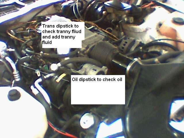

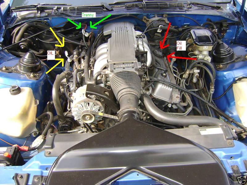

Oil Dipstick is Black handle shaped like a T Pass side middle of valve cover
Trans dip stick Red or Grey handle shped like ring you can put a finger thru Pass side back of engine by fire wall.
Oil cap( were to add oil) Driverside valve cover toward rear
I'll look for a pic to show

Here are Pics

heres the pics i have... Sry if they're a little blurry they were taken with a camera phone:
umm let me try that agian
and also since it was mentioned earlier.... ?action=view&current=0909081902b-1.jpg&t=1220929602789

Thanks for the pic, I'm gonna have to look for the oil dipstick again tomorrow. I looked for a good 30min in that area and couldn't find it!!!!
I don't have a loop like you so maybe it broke off or something, I put one quart of the correct oil in the car, 1 is better than none.
these are 2 older pics, the ones i just took did not upload right
Old Sep 10, 2008 | 05:26 PM
buell's Avatar
Joined: Jan 2008
Posts: 183
From: Jarrettsville,MD
Car: 87 camaro iroc
Engine: 5.7L
Re: Noob Question
Picture is too blurry to tell anything really.... what is the ? though? also the manual the one post mentioned is a great idea i picked up one myself at the local pep-boys / salvo and its helped me more times then i can remember... also at somewhere around $20 they are one of the best investments i have ever made

Ok see the big silver cylinder thing on the left
Just next to it on the right look in that area you should see the oil dipstick
Old Sep 10, 2008 | 08:47 PM

there are two dip sticks on the left side , it is the one closest to the front. its not hard to find.
alright i just went out and looked for you on my car. look at your motor from the front of the car. to the left there is a cylinder shaped piece of metal that is silver. its a little bigger than a pop can. go two inches or less to the right, there should be a tube there with a handle coming out of it, although it is possible you dont have a dip stick. but the tube should still be there, it will be a very small tube like the size of a straw

Okay noob, don't let these other cats bust your do-dads over this.This is what you do.Pop the hood and get a flashlight, whether it's sunny outside or not.Look CAREFULLY and SLOWLY, "feel" if you have to, to find your dipsticks.The oil dipstick is closer to the front of the car and the trans dipstick is closer to the firewall, er, windshield. My oil dipstick has a black T shaped handle with the words "engine oil" on it.The trans dipstick is red and has a ring shaped top.A REMINDER--check trans fluid when the engine is warm and running.Check OIL when the engine has been off for awhile, or first thing in the morning.Don't fart with the trans dipstick at this point; it dosent have Bo Diddley to do with oil pressure.Found it?Good! IF NOT take the car to a decent quick lube place (not jiffy IMO) and watch what they do.I have been changing oil since I was 13 (older bro's 55 Chevy),but I had to break down and take my RS to a Valvoline instant oil change simply because the car sits so damn low and my ramps would ^*** up my front spoiler.Lastly, get the correct Chilton's book for your car.Learn it- live it!!
