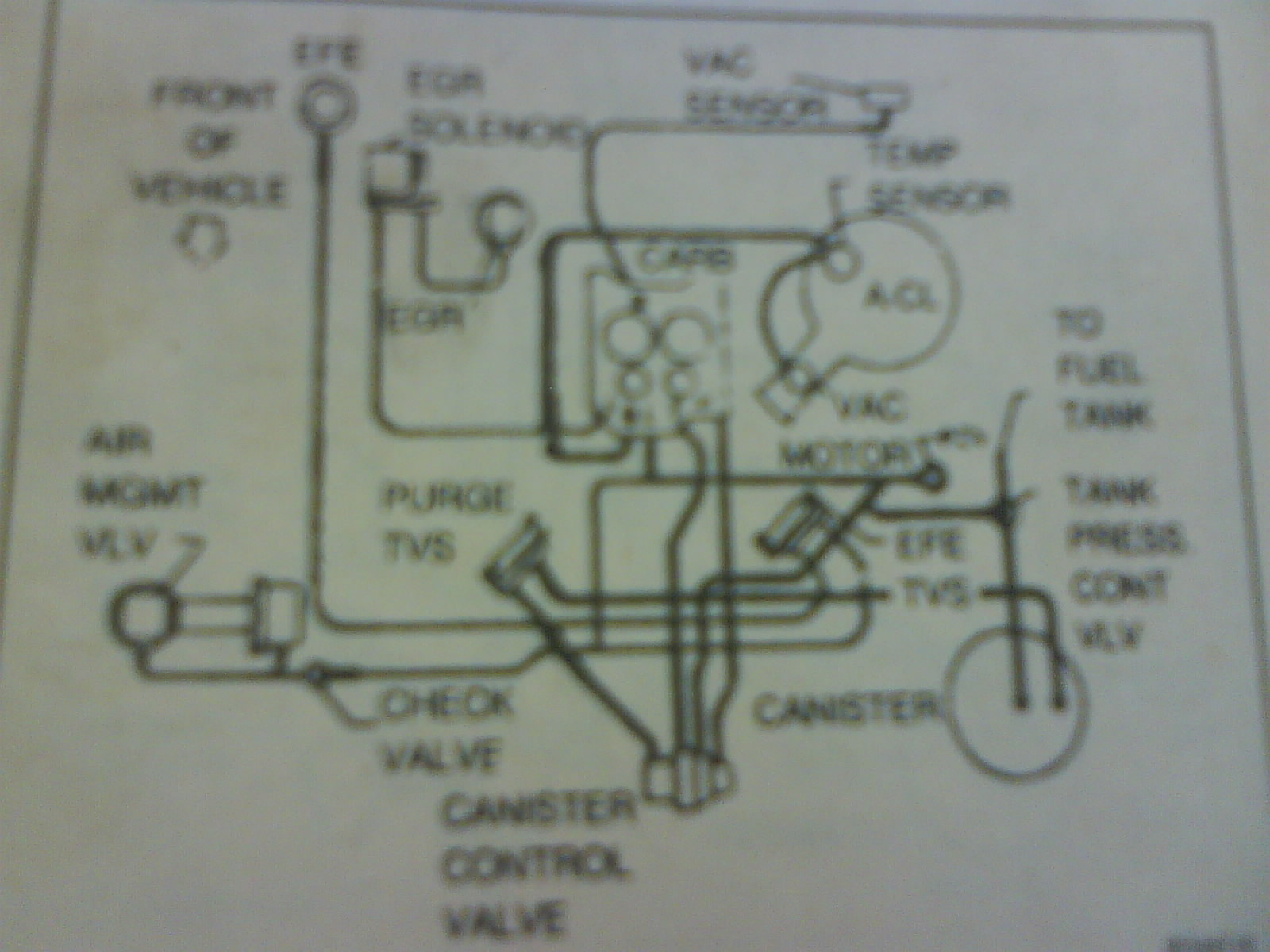

My car has a 2100 rpm idle.. Ill make this short and simple.. What is causing this high of a idle? I know it can't be anything small.. Because then it would be at like 1300 or so.. If it isn't a vacuum leak then what is it?
Ill make myself feel like a total dumbass right now because the idle was fine until i started messing around with all the hoses and stuff.. Maybe i could have put a hose in the wrong place? LMK some main places to check out.. maybe even some pictures of a carb'd 305 engine

vac line to the map sensor maybe

Wheres that at? That could be a problem actually.. I have 2 small tubes that have no connection..

firewall, near the heater box, on the passenger side...... some should have a pic and if needed i can find the vac line diagram

Yep.. Thats where 1 of the disconnected tubes are.. If you can get a picture.. that would be awesome

ok im guessing and hope you have a carb motor, and not CFI
take the air cleaner off, look on the very back of the carb, you will see a small vac port (port "N" according to the book) run a line from it to the vac sensor (im sorry it looks like its on the left side in my book, sorry i said right ealier
check all your other ports, if they dont have a line hooked up plug em, or fix em,there is a total of 5 ports on the front it look like
look under the hood their may still be a emission hose routing sticker under there use it to help

Yeah.. Its carb'd
I went over everything today and got the idle down to about 1500 from the 2100 before.. Looks like im doing something right. lol.
Maybe i should mess around with the idle screw? I dont know where it is though. lol.

Its going to hard to explain this.. ill take a pic tomorrow but.. I have 2 of these little tiny tiny tubes that have a 3-4 inch rubber tubing at the ends.. They are both free and i dont know where they go.. They are like little tiny plastic tubes. That could probably be a problem too. I got 1 going into the egr valve thats the same type and goes into the same place

yea i will post a pic to help as soon as i can

hope this helps
