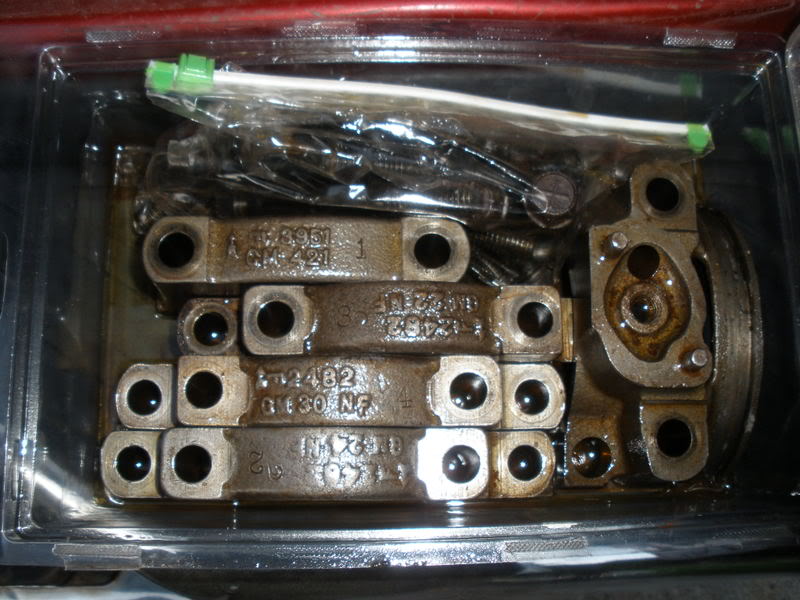

Fully machined main caps

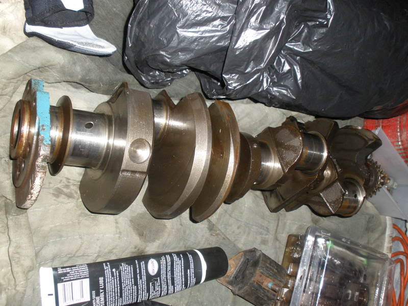

Brand new, 350 crank

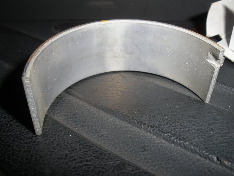

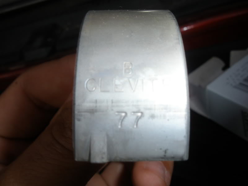

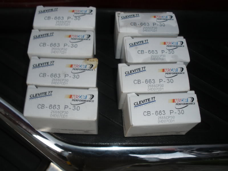

Brand new bearings

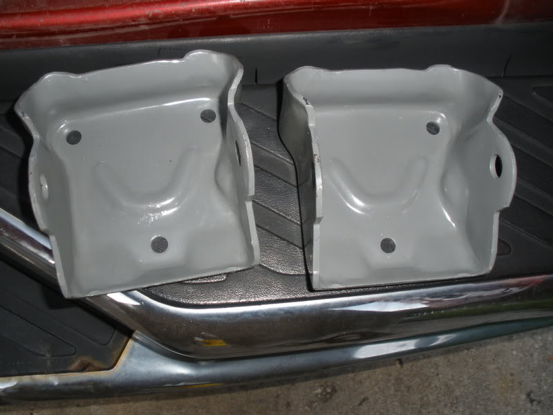

Brand new mounts

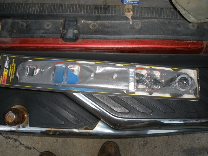

Brand new gaskets

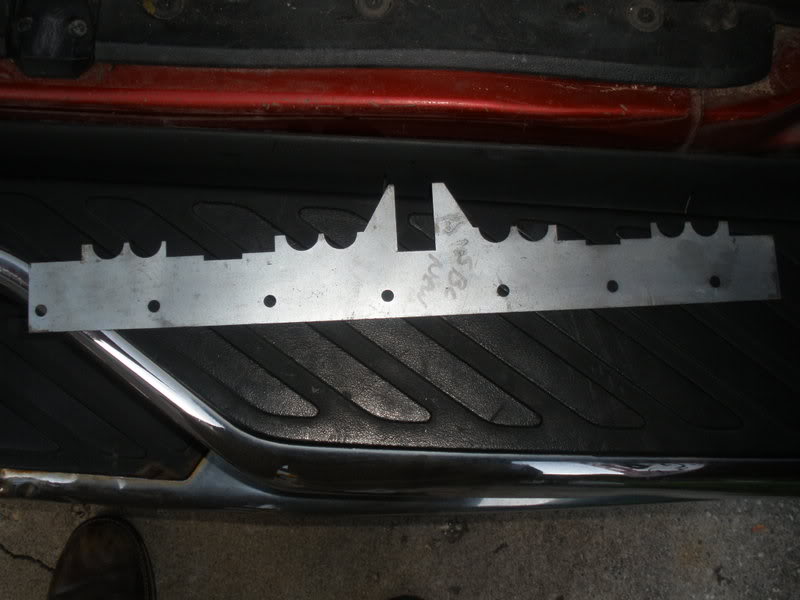

Brand new crank scraper
