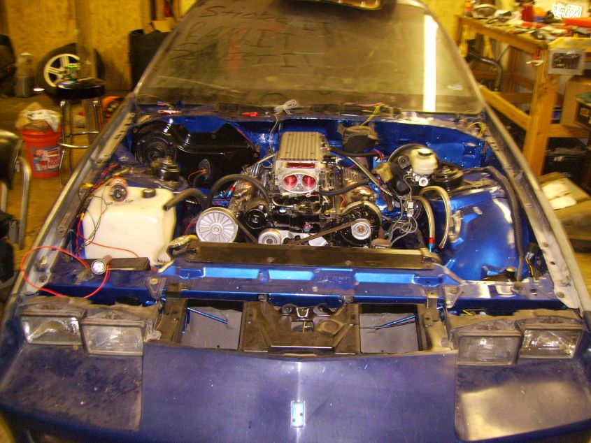

I was hoping to see some pics in this thread...
Old Nov 19, 2008 | 03:22 PM
spills's Avatar
Joined: Nov 2004
Posts: 996
From: Buford, GA
Car: 89 RS
Engine: 6.3L Megasquirted HSR
Axle/Gears: 3.70 Posi 9 bolt
Re: POST YOUR VORTEC SET UP!
here ya go. Few months old, car's come a long way since.
Attached Thumbnails POST YOUR VORTEC SET UP!-sany0137.jpg   POST YOUR VORTEC SET UP!-sany0129.jpg
