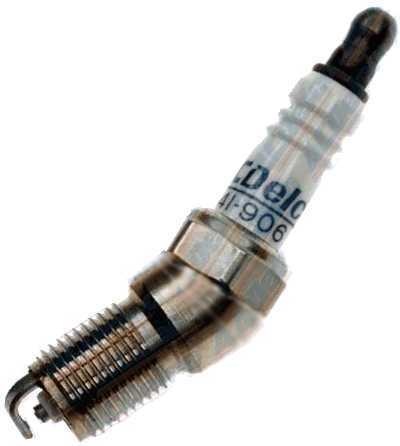

Actually, if you are anticipating having trouble with header clearance, you can try angle plugs:
But seriously, any good standard plug should be suitable, so long as the electrode position is correct, reach is correct, and heat range is correct. Even the stock plugs can be wrong for a modified engine, so consider the installation. Champion makes good plugs, NGK makes good plugs. Autolite is a commodity brand, made to be sold, not used. These are the same people who offer the Fram line of products, so consider the source.
