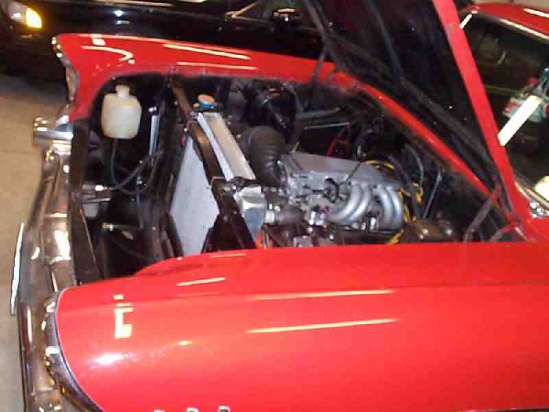

How old are you talking?
As long as it isn't a '55 with no oil filter boss on the block, it will work.
If the TPI is from a 1989 or older Corvette, it will fit older heads.
