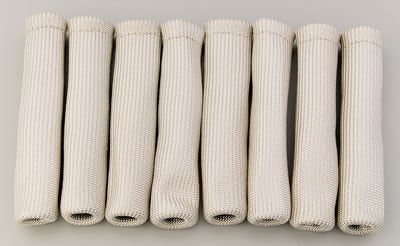

I had the same problem years ago, so I bought Taylor heat sleeves from summit and have had a problem since.

Melting plug wires, now they can touch all they want and nothing happens.

Like he said get some of these, all the race cars have them to keep the wires from melting on the headers. They may look expensive but trust me i use them they really work. Mine sit right on the headers and have NEVER melted a wire.

Yes I'm sorry, I did mean "haven't had a problem since". I have 1 3/4" headers and my plug wires also sit on my headers or are very close too.
