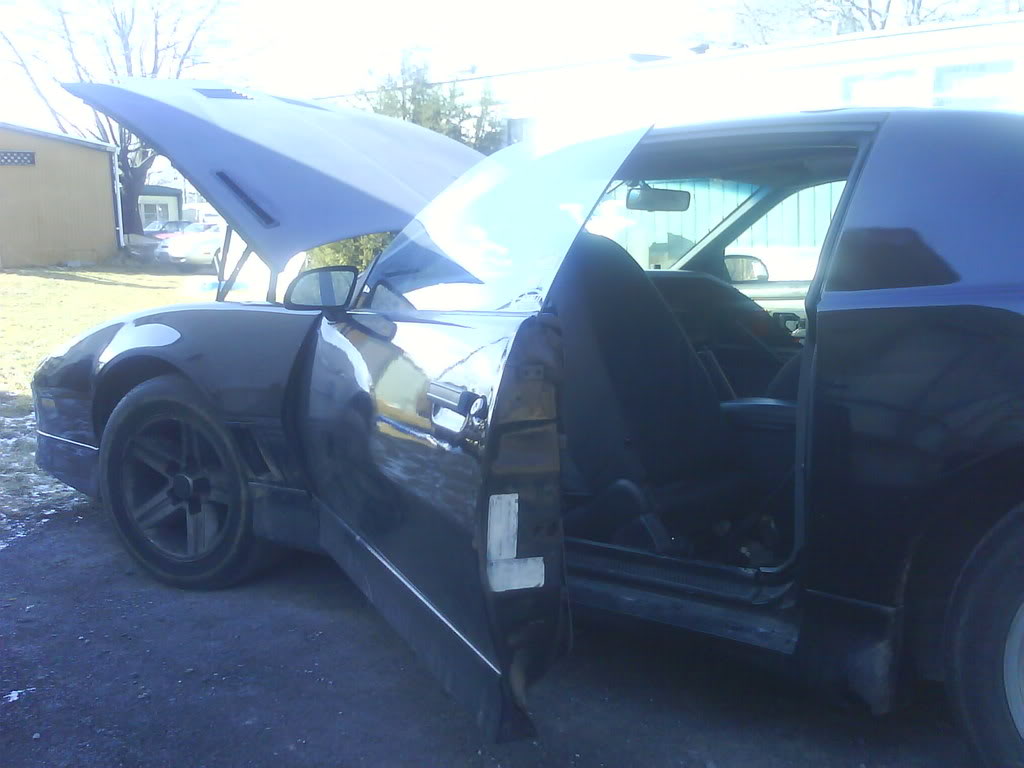

Hey all. My first T/A, and she's a beauty!
It's an 85. Has t-tops. All black. Real straight and glossy.
I'll be towing it home in a week or so.
So there it is.
Looks nice...but slightly broken.
Like I said in the topic....It runs...knocks and shakes a bit...and the owner said once it warms up, it loses oil pressure....so he just shut it off. He isn't sure what's wrong with...and neither am I. It didn't sound half bad while it was running....I've heard engines knock louder and continue to run.
What's wrong with it? Any ideas??
Thanks a million!
-Tony.

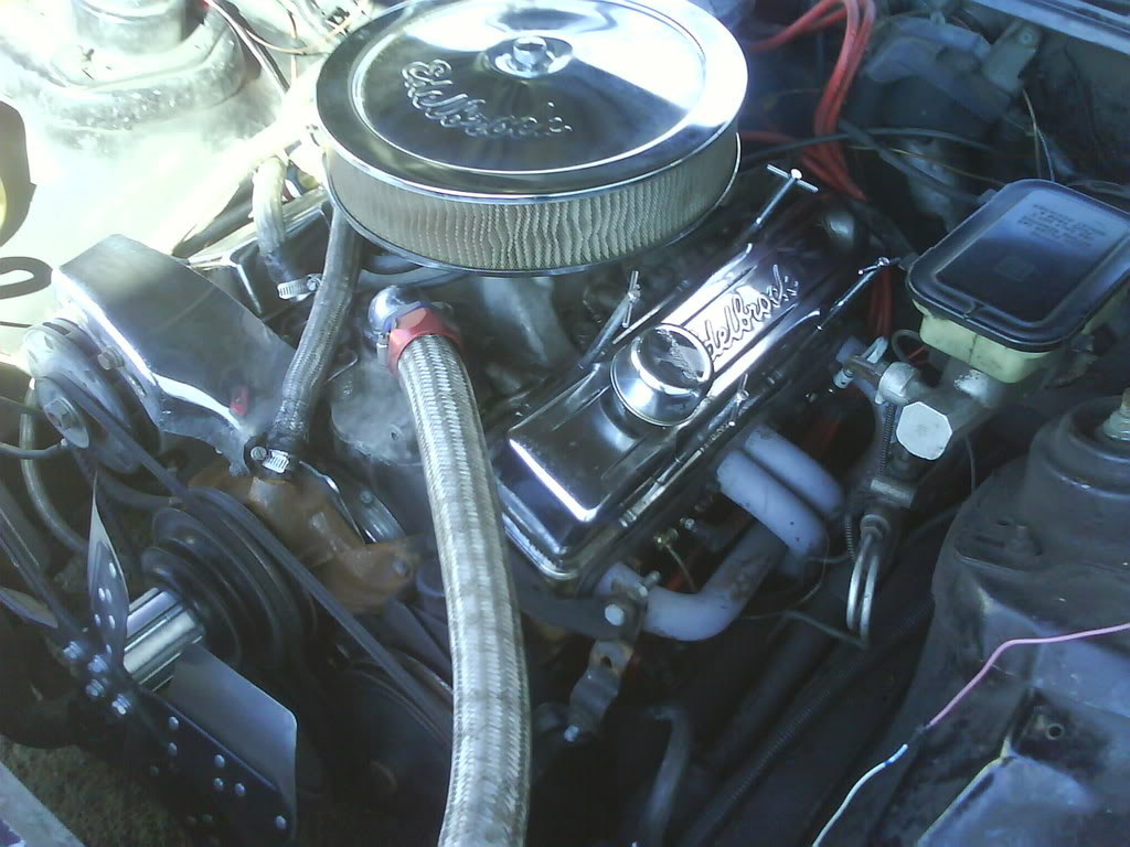

So I've had the car a couple weeks now. The battery is useless....wiring harness is a huge mess....the car is hot-wired on some random plug...I have no idea.
However...it DOES run...and I must say...not too terribly. I took it for a spin. The clutch is very um...finicky. I stalled it a bunch of times...because I'm used to my very small Geo Tracker. In order to get it to drive away from a stop sign...I was spinning the tires on every launch...oops!
It indeed does lose oil pressure like the previous owner said....but very gradually...took like 10 or 20 minutes to drop to around 15lbs at idle....and when I gave it some throttle...it jumped back to 40-50lbs.
Can it be that a previous owner never replaced the stock oil pump when boring and adding all this extra power? Perhaps it's not getting enough oil? Maybe if it indeed DOES have a spun bearing....it's BECAUSE of a lack of oil pressure....does that sound right?

15 psi at hot idle isn't dangerous by itself. Still, it's nearly spring, so switch to 20W50 or straight 30W for a wee bit more. The real issue is the knocking. I'd start by pulling the valve covers and checking the valvetrain. If that's all good, then drop the oilpan.
