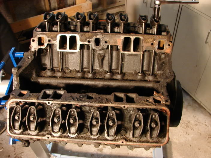

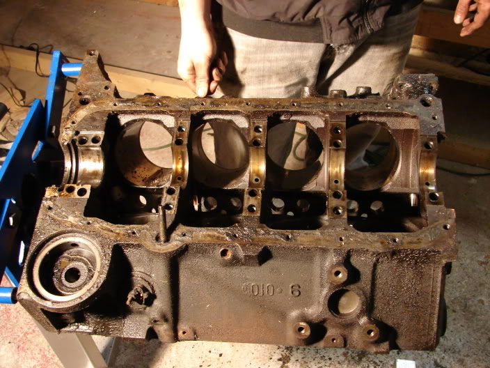

*Block when I Got it*

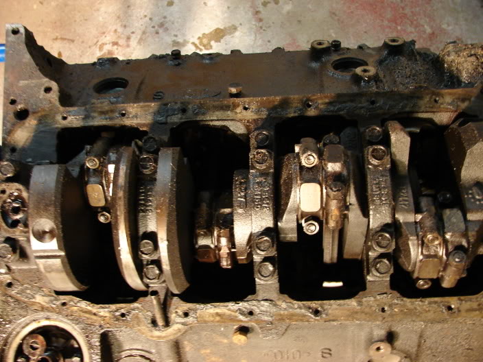

*Crankshaft*
*Without Heads*

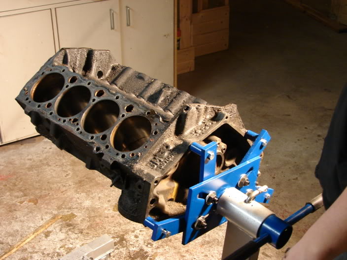

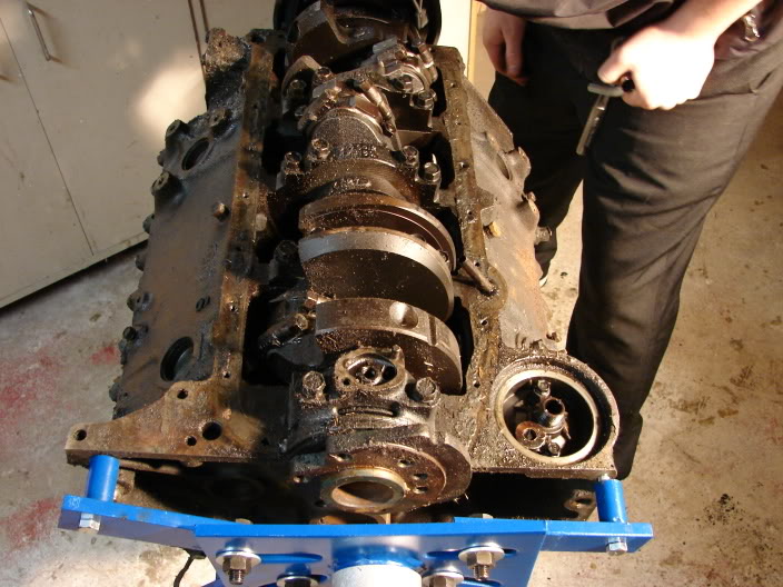

Sorry got a little picture happy
Alright thats it for now until i get the money to take it to the machine shop. Kind of hard to build an engine and save for a new vehicle lol. I'll be back with updates.

With the cylinder rust will probably need overbore.
looked like there were traces of blue paint on the
engine,that would indicate '77-79 model years-
small block chevys were painted blue from '77-82.
A racer once told me that the"010" marking on the
side of the block meant those blocks were "high nickle"
blocks for heavy duty applications. Heads looked like
they might be the lightweight style which can crack
if they have been overheated-check 'em close.
also those heads can be improved by a mild port job
-really helps(some of the truck heads have small
valves with thick stems for greater durability under
load,not the best for high performance) also helps
the oiling some if the oil hole in the rear main cap
is "ported" some to improve oil flow a bit.
good luck and have fun!

Seeing as he plans on building it into 383 he'll have to bore it anyways. Also, I doubt he'll be reusing the stock heads on a 383.

That 010 high nickle stuff is bunk.
Looks like it has a freeze plug block heater.
Get the casting #'s from the heads. Most likely they're not worth keeping.

The 010 on the side of the block doesn't mean anything, its simply the last 3 digits of the casting number replicated on the side of the block. "search" TGO for high nickle block identification, it relies on numbers cast into the block under the timing cover.

If the block is a 3970010 block, it could be a 302 or 350 according to the Chevy block casting info on mortec.com. All you have to do is measure the bore or piston diameter, that will tell you which size block you have.
I have the same block, just in the 2 bolt flavor. Got mine for free as well from a friend who was gonna rebuild it but needed to clean out his garage and had 2 other blocks waiting to be rebuilt.
If all you want out of it is 350 fwhp, keep it as a 350. If you do go with a 383, 400 fwhp should be the minimum you shoot for. However, I agree that you'll probably need to have it bored judging from the pics of the cylinder walls. If that is the case, you might as well go 383. The extra machine work shouldn't cost that much more I would think. Especially if you have a friend that works at a machine shop. You could also see if you can take it to school as an extra credit project or something since you are going to Wyotech. Not only could you get the work done for free/little cost, you could help your grades too
Do you know why the block was at the machine shop? From one of the pics it looked like it was leaking oil pretty bad.

The 3970010 can be a 302, 327 or a 350, with either 2 or 4 bolt mains. This one has 4 bolt mains. As for bore size, it won't help anybody, all three of the above engines had 4 inch bores, it was the strokes that were different. 302 had a 3 inch stroke, I believe the 327 had a 3.25" stroke and the 350 has a 3.48" stroke. So if you want to know which it is, measure the pistons vertical movement.
