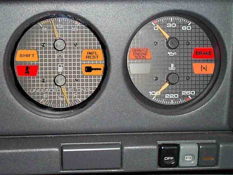

Next Stoopid question: Where is the SES light on an 85 TransAM?
Mine is obviosuly not working and I don't know where to look for it.
need it working before i test the ecu and engine codes etc.
Anyone got a picture of where it is?
And..... if the bulb is blown si there any easy way to change/ rewire an external bulb?

If you don't have a working MIL, you can connect one at the ALDL:

Re: Next Stoopid question: Where is the SES light on an 85 TransAM?
Thanks for that.
Got the SES light working now, had to take half the dash out.
Was kinda disappointed when i got a code 12.
