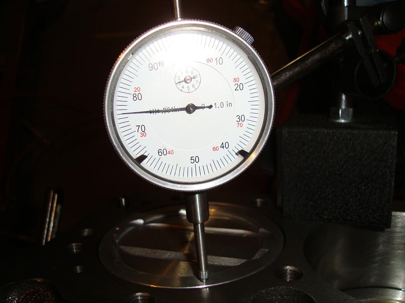

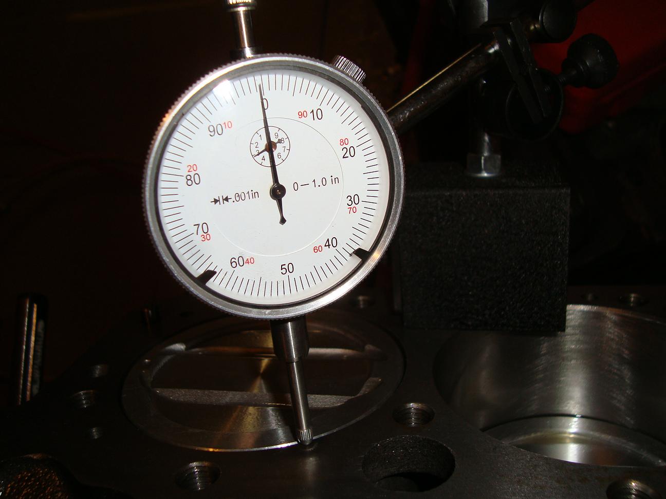

Just needing a sanity check here..
I bought a brand new GM L05 short block from SD. It has 4 bolt mains, cast crank, -18cc dished cast pistons & stock deck height 9.025".
I am trying to confirm some measurements so like i said, just needing a sanity check. Here are the pics of me measuring piston to deck height, i zero'd out the gauge on the block then carefully moved it to the edge of the piston, this showed .025" difference right?
Also want to check my CR calculations.. I have a brand new set of trickflow heads with 62cc chambers. i plan on using a 4.1" bore, .015" thick head gasket (I know this is thin but I have read people have had many good results with this and I have all brand new components so my surfaces should be level) - this should give me a 0.04" quench height. With my stock 4" bore and 3.48" stroke, i should be making 9.1:1 CR right?
Thanks guys, just wanting someone to double check my thinking for me.
Thanks,
Richard.

I'm coming up with 9.1126:1 Yes, it's safe to run those gaskets with your pistons that far in the hole. It's what I do. For myself and most of my customers. Note: new heads, fresh out of the box, need to be checked with a long machinist's straightedge. The machining was done while the heads were still hot from the casting, and the heads cool in the boxes. If they're not perfect, a light shave to remedy it will put you at like 9.2:1, still pretty low. Are you planning on running a supercharger or turbocharging?

It just hit me what's bothering me. And it isn't boost with cast pistons. I think those pistons look like 12 cc, which would be good for non-boost. Closer to 9.7:1 or 9.8:1.
