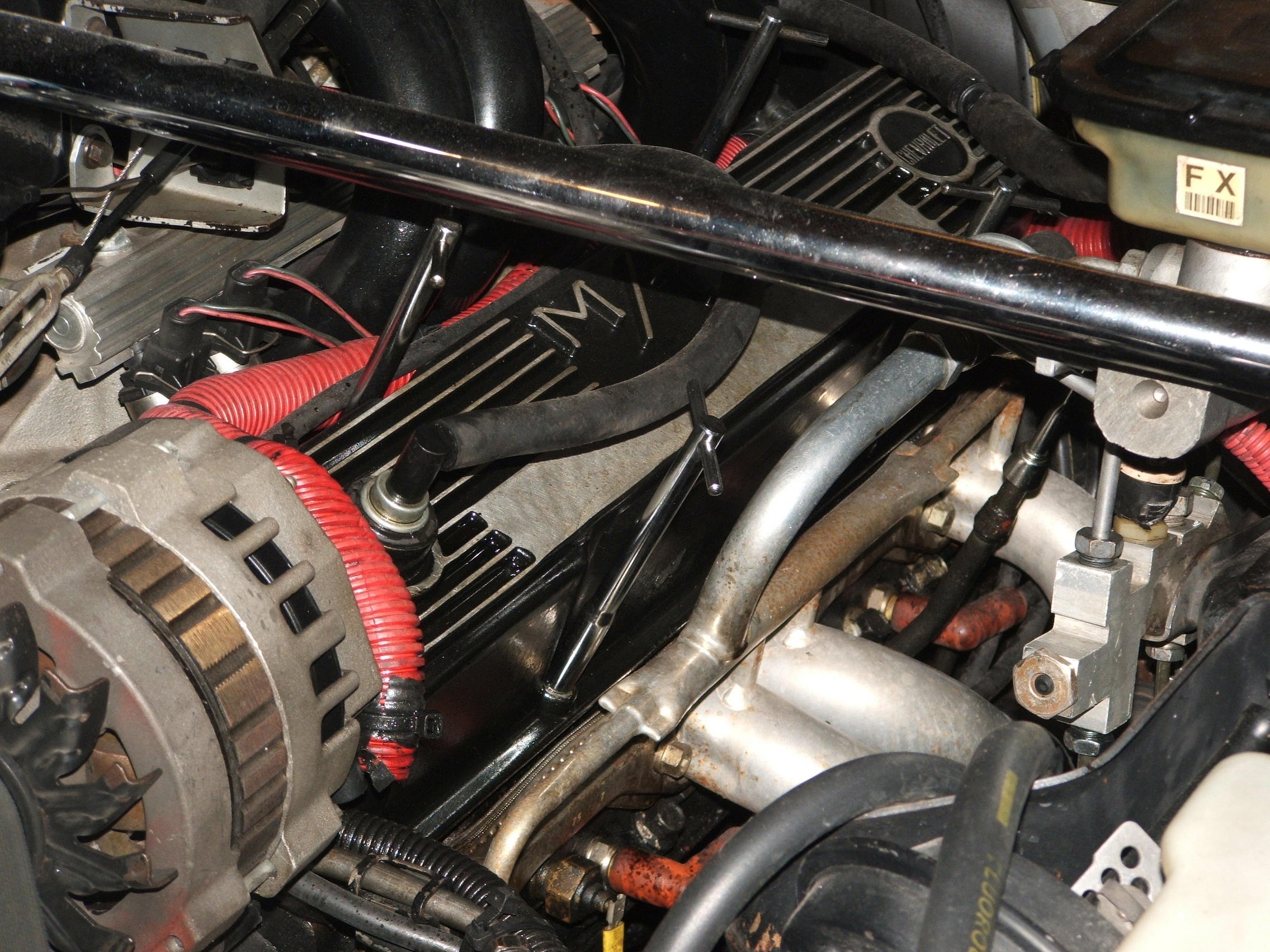

I found the same valve covers that were on the first sbc I ever bought
they were the first item to get painted with implement paint and urethane clear and have held up great on a hot and cold motor.
needless to say I have to take the alt and ac compressor off to get them in but I dont care. I really like these valve covers
anywho they leak like a sive and I cant find a gasket to seal these babies up
man I would hate to take them off.
thanks for the help and if you dont have these valve covers you will not know so please no guesses as they are a pain to do

The "upgrade" gaskets will typically do a better job than the standard gaskets available from most any name brand. I haven't had much respect for what Mr. Gasket has been selling for the past several years, although their higher priced Ultra-Seal line is better than standard stuff.
I've had pretty good results with Fel-Pro. See what you think of these - http://store.summitracing.com/partde...T&autoview=sku .
FWIW, I had M/T covers like those (plain aluminum) about 30 years ago. Never had trouble with them leaking, but I had them off about once every two months to adjust the solid lifters that engine had, and used cork/rubber gaskets which lasted about 5 remove/installs before I had to replace them.
(BTW, I wasn't offended. Just intended a little light hearted humor, at your expense, of course. I'll behave now.)

The one I linked is a rubber coated steel shim. Not likely to blow out.
