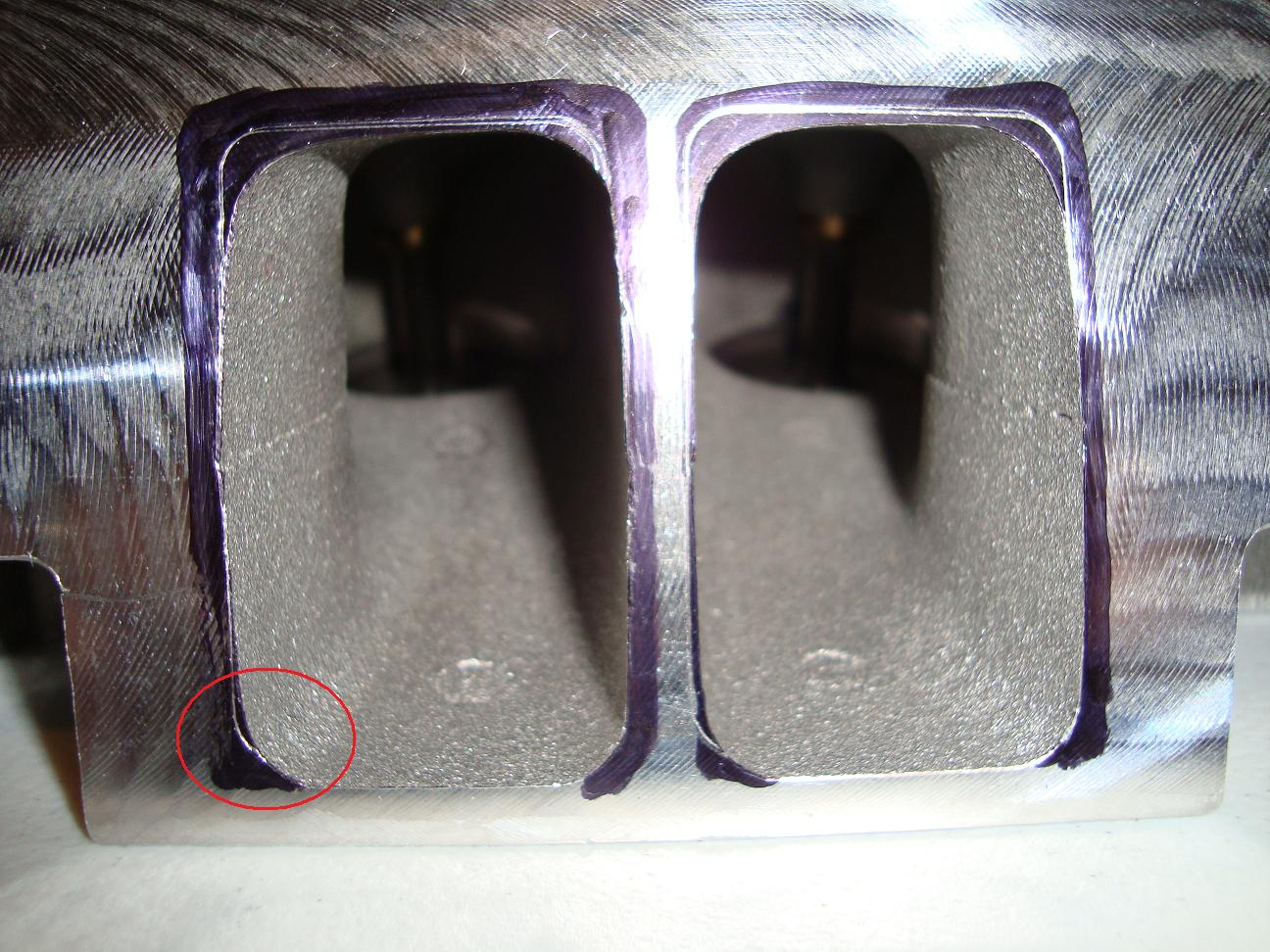

I just got in my Felpro 1205 intake gaskets and intended on matching the ports on the new Trickflow 195 heads I bought. I have marked the intake ports with a sharpie and laid on the intake gasket, I then marked around the inside of the gasket to show how much material on the head to remove.
My question is though that the gasket is smaller than the head port at the bottom of the port.. Should I just increase the size of the gasket here or what? If I increase the size of the gasket, I am worried that the gasket will end up to big to be able to port match the TPI intake base.
Any guidance is appreciated.
Thanks!

I am attaching a pic of the intake ports on the heads. I have scribed the outline (inline maybe?) of the 1205 gasket and as you can see (I circled one port) the bottom of the gasket protrudes into the port area.

Are those the recommended gaskets? I personally don't know one way or the other, but they shouldn't be smaller than the port anywhere.

Yep - Recommended gasket size per the instructions I recieved with the heads.

Can anyone else chime in on the gasket question?
