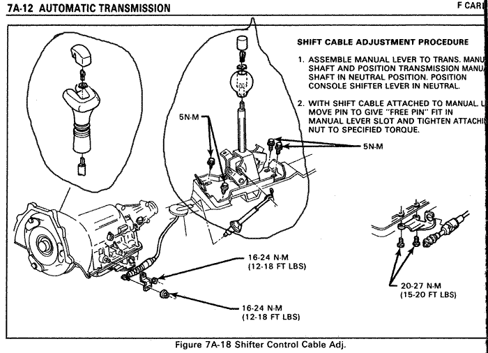

look what i found in about 5 mins with the

That's a nice diagram. I still cannot see what holds the ball from sliding. I replaced a clip that broke when I took the ball off to fix the ashtray. I have 2 extra clips btw.
