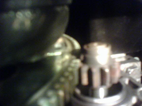

Ok update:
Went under the car, found that the bendix gear/starter gear is stuck out into the flexplate, it did not retract. I went from 1/32 to 1/16 to 1/8" in shims, same problem each time I tried to turn it over. So I wonder, hmmmm? How would I know if a relay or switch has gone bad or if the solenoid/bendix gear went bad?
and
then unstuck by hand

Well the battery was fine, starter is fine, My DieHard charger is fubar really. Took the battery to Autozone, he tested it and was surprised how great the thing was with a load on it, only went down to 11.7 volts, something like that. Cleaned the posts off for me, I replaced my leads with 1/0, threw in couple shims and now she starts right up.
Yeay. Now I just have to fix the leak at the speedo cable... new seals on the new driven gear and the oldsmobile/gm style housing. The cable is very flexible can move around easy inside the cap that threads onto the housing, and leaks around the cap, eh.... going to check the o-ring, see if it has to be driven on further and maybe put another on there and seal'r up with black RTV.
thanks for the help and input guys
