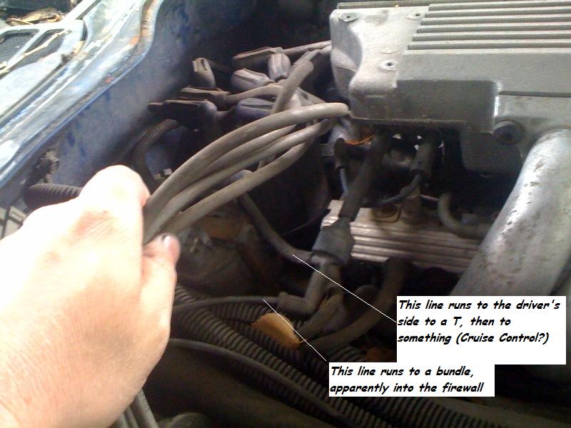

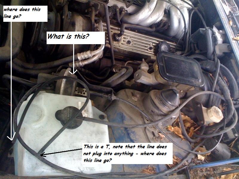

OK, so I changed my A/C to R134a and finally got cold air for the first time in years... now I am fighting the problem of the air only coming out of the defrost vents.
Checking under the hood, I found 2 vacuum lines disconnected. One I was able to figure out where it went, the other I cannot.
The line is connected to something - I do not know what it is (see picture)... can anyone help? Thanks!

Check and see if the plastic ball underneath the driver side tray there, under the cruise control canister has the vacuum line attached... if not, that is the line for it.
Edit- that thing you put "what is this" is for your cruise control I believe, the plastic ball underneath is for vacuum.

Originally Posted by Chevy86 IROC-Z
I need some help too. on one of the last pictures, it shows on the back of the plenum, a small male fitting that is supposed to go to the HVAC. Can you provide me a picture of your HVAC vac line?
I hope this is what you are referring to:
OK,it makes sense that the "what is this" is the cruise control, as one of the connectors goes to the throttle. I do not see a plastic ball - when you say "driver side tray, under the cruise control canister" I do not know what you are referring to.... is the thing in the picture the canister? Keep in mind the Firebird vacuum canister is on the passenger side front, and the Camaro's is apparently on the driver side... thanks.

What about charcoal canister - on the camaro's there is a black canister about 5 inches in diameter on the driver side where the battery is at on pass side. There is a vacuum line runs to it I believe. The canister grabs fuel fumes every so often (ECM controlled) and holds them.

'fraid not... on the firebird, the charcoal cannister is on the passenger side front, and I have been able to check all the lines from it are connected properly. thanks

update: I think that line is supposed to go the "orb of power", the vacuum reserve cannister. I found it under the battery tray (driver's side on the firebird), and it appears there is nothing connected to it. I am going to remove it and see if I can get it hooked up.

you got it, thats the one I was talking about underneath. Hope it all works for you! Reminds me I have to remove mine.

I was unable to get the "orb" out do to corrosion of the bolts holding it (sitting right under the battery).
So i just pulled the line to the orb and pushed it in the side. It seems to be in there pretty good, but the AC is still blowing only from the defrost vents. bummer.
I will pull the climate control unit this week and see if there is a leak there....
