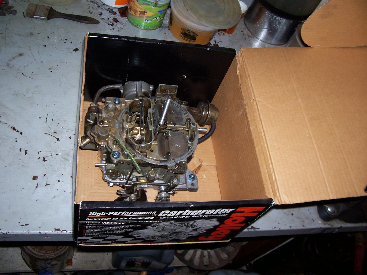

Tim is probably going to kick me for this, but you need a "Holley" that looks like this:

That's a funny looking "Holley"! Kinda reminds me of the time I saw a freind of mine in his 1966 Porsche, a decent car but showing a little age and wear. "Nice car" I told him. "Thanks", he said. I say. "I've never seen a VolksWagon like that before!" I can't print his reply.
Why would I kick you for that? It's my favorite street performance carb!
