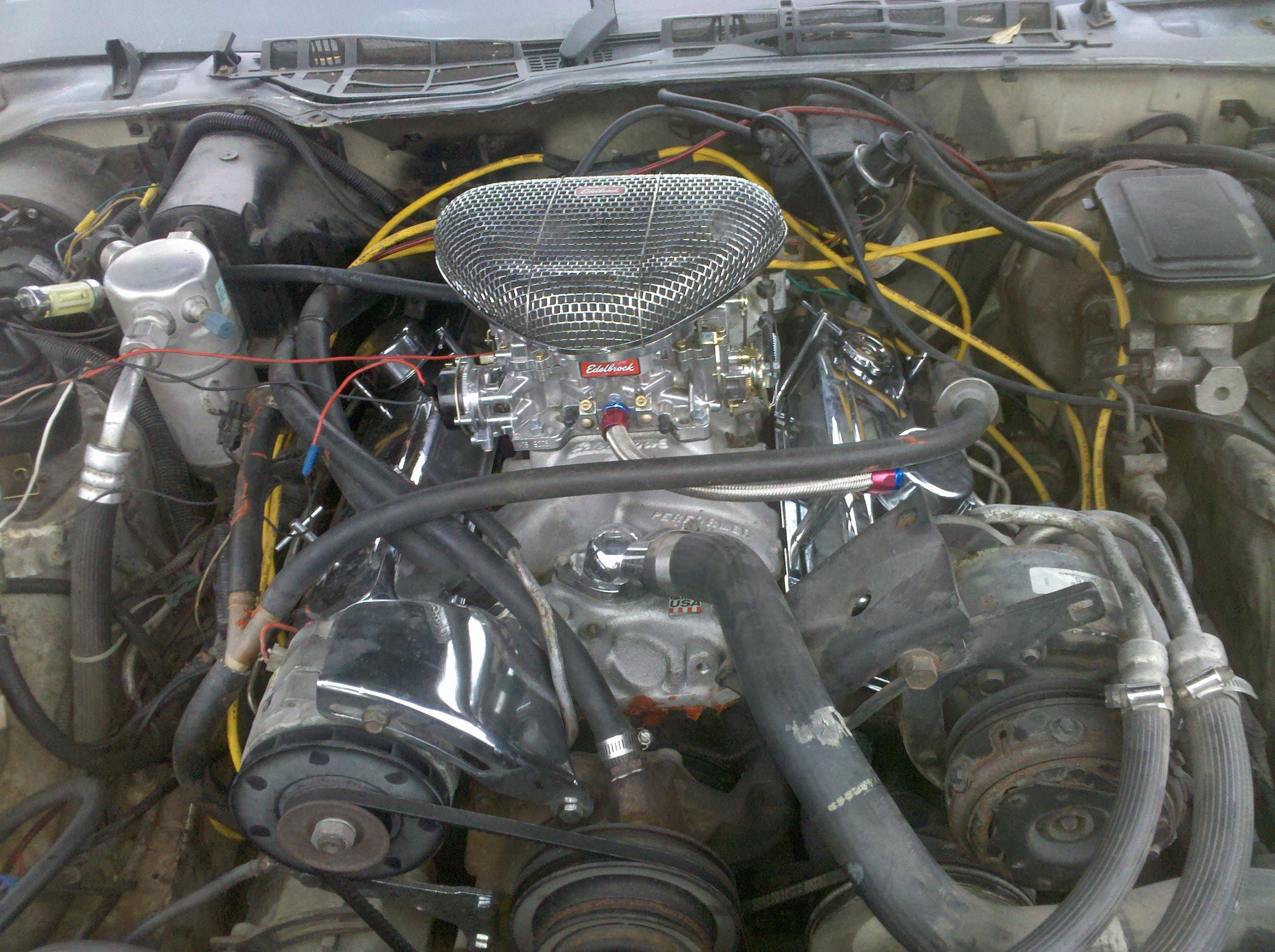

83 Z-28 $1500 Should I buy???? HELP Pics included
I'm looking at a 1983 Camaro Z-28 305 5 Speed Brand new completely redone interior, body is pretty straight already primered, im looking to build it with a new engine later is this a good starting canvas?
He is willing to take $1500.00 It runs good shifts good not sure if $1500 is too much what do you guys think?
Attached Thumbnails 83 Z-28 00 Should I buy???? HELP Pics included-interior.jpg   83 Z-28 00 Should I buy???? HELP Pics included-engine.jpg   83 Z-28 00 Should I buy???? HELP Pics included-right.jpg

This is true. Also couldn't tell you what engine but I can tell you you have a decent intake there as well.
Also the shiny POS carb :P

Re: 83 Z-28 $1500 Should I buy???? HELP Pics included
I'd look elsewhere. The appearance of the engine bay turns me right off.
The place is a total hack job; choke heater wiring, misc. wires all over the place, plug wires aren't tidy, drippy RTV, hacked AIR injection hoses, etc.
Check the hose that's running from the front of the carb to the VC. It should be connected to a PCV valve, not a breather.
For me, appearance tells me a lot more about the car than anything else. Things like this are red flags. Sure, things things can be fixed, but it makes you wonder about the things that aren't readily visible. It also calls into question about the quality of the interior. It looks good but is it really?
Don't go into this with blinders on. Think long term which usually means lots of time and money down the road.

I took yours and others advice, I went and looked at it and decided not to purchase it. I'll just wait and find a better deal elsewhere.
Thanks!

I agree with you so much on this. It seems like everything is randomly placed. You can tell the fuel filter is running an oddball way. There is a nice edelbrock carb on there, but i my opinion it is worth 1300 dollars. Good Luck!!! Hope it all works out for you.
